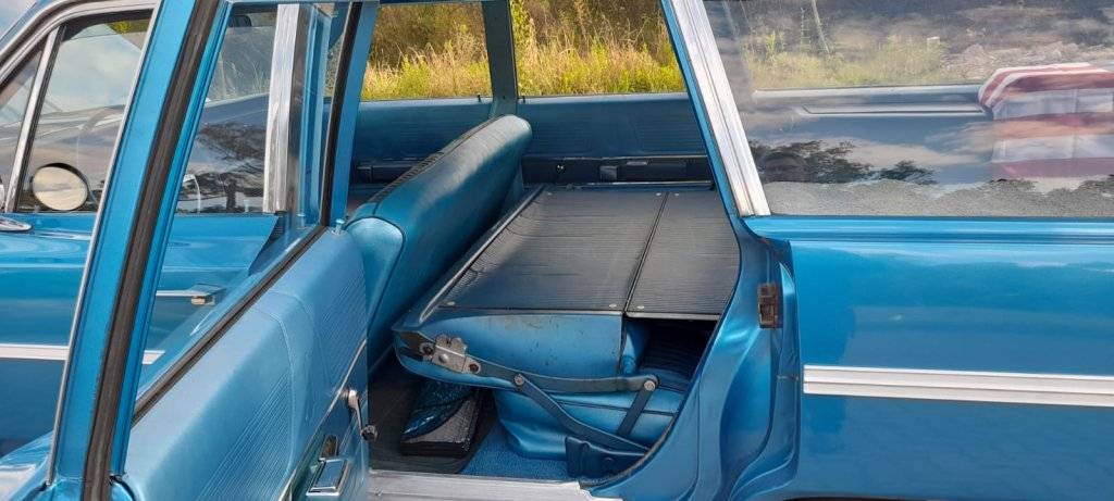

I used 4dr carpet for my 64 and fit no problem. I just got some extra carpet for the rear foot well for the 3rd seat.
