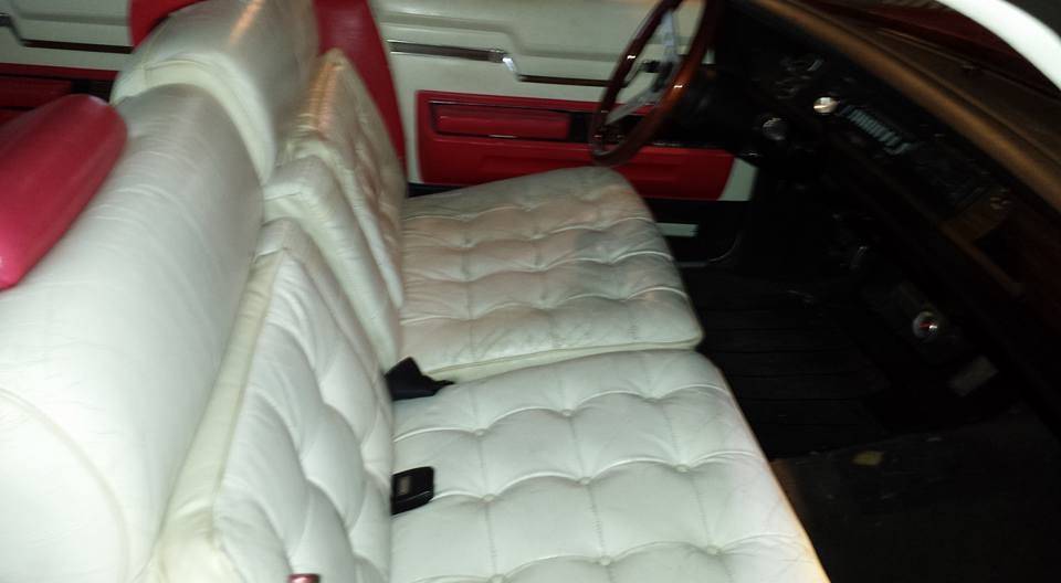

My vehicle hasn't been here a week and it's got the nickname "Big Red" in our house...wife likes it so major battle won...I would like to tone down the interior red the PO highlighted with painting the headrests and various panels red...back to white or black I think...don't know if red can be removed with something or have to be repainted white or black? Anyone have to deal with upholstery paint removal or respray?

Thank you for all feedback...your opinion on painted red upholstery/panels highlights returning to either white/cream or black to match dash would be greatly appreciated. What do you think? Original was probably white/cream?
Original IMHO.
buuuuuut if said parts do not clean up to your liking, a spray of black will hide the PO's previous sins.

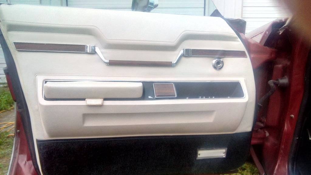

I wouldn't put a ton of effort into removing the clown-makeup your PO added. Some of those pieces can come from any C-body with a white interior (like the headrests and A-B-C pilllar trim). It will likely need some freshening with white vinyl dye, but that's one coat vs. God knows how many to cover red.
The pieces that are a bit more rare, like the door panels.... I'd get a price (a guy like Murray Park would have them). Consider the value of your time and what would surely be an awful job. And you'll still have to freshen them.
If that's too costly, start with something like the aforementioned Goof-off and work your way up to lacquer thinner.

My '73 has the same white leather interior, I'll get some pics so you can see what it's supposed to look like. The only things that is black in mine is the carpet and the dash.
