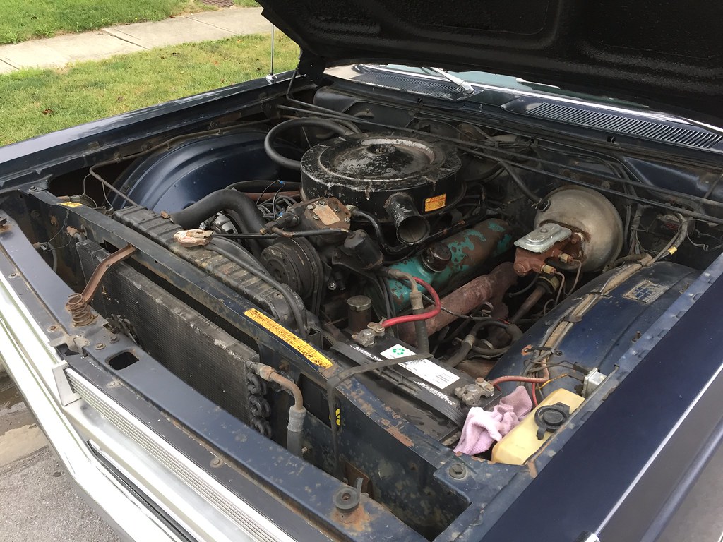

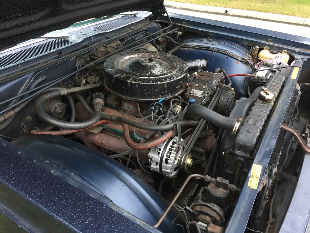

Posted a thread in the general C-body forum introducing myself, but I have a few technical questions that are probably more suited to this forum. My car is a 383 2bbl car, 727 trans.

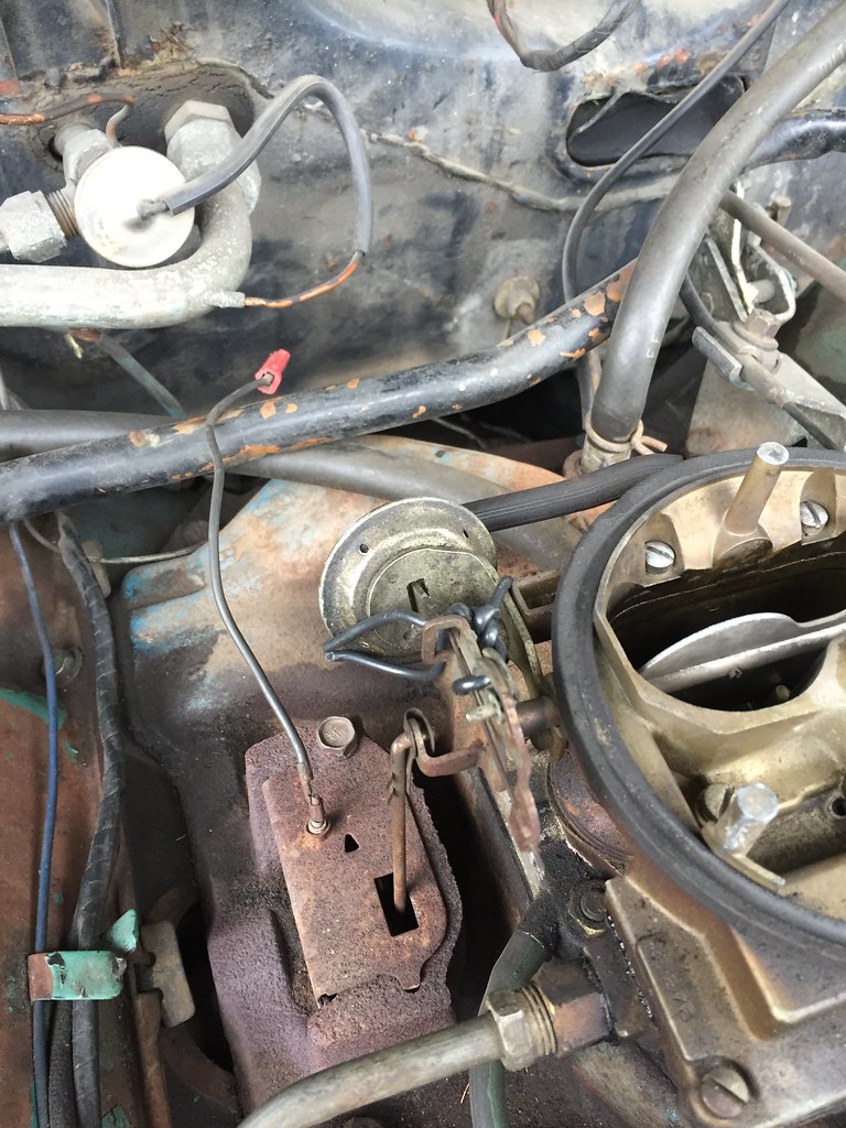

-Choke is inoperable. Not a huge deal, but I'll probably fix it and rebuild the carb at the same time. It's a Carter BBD correct? Mike's Carburetor Parts stocks two kits for this car and carb. Is there a particular one I need? Does anyone have any good info on the theory of operation of these chokes? It looks like there's a vacuum diaphragm on the passenger side of the intake that has a bolt coming out of the vacuum line, and it looks as though the choke pulloff is tied up with wire.

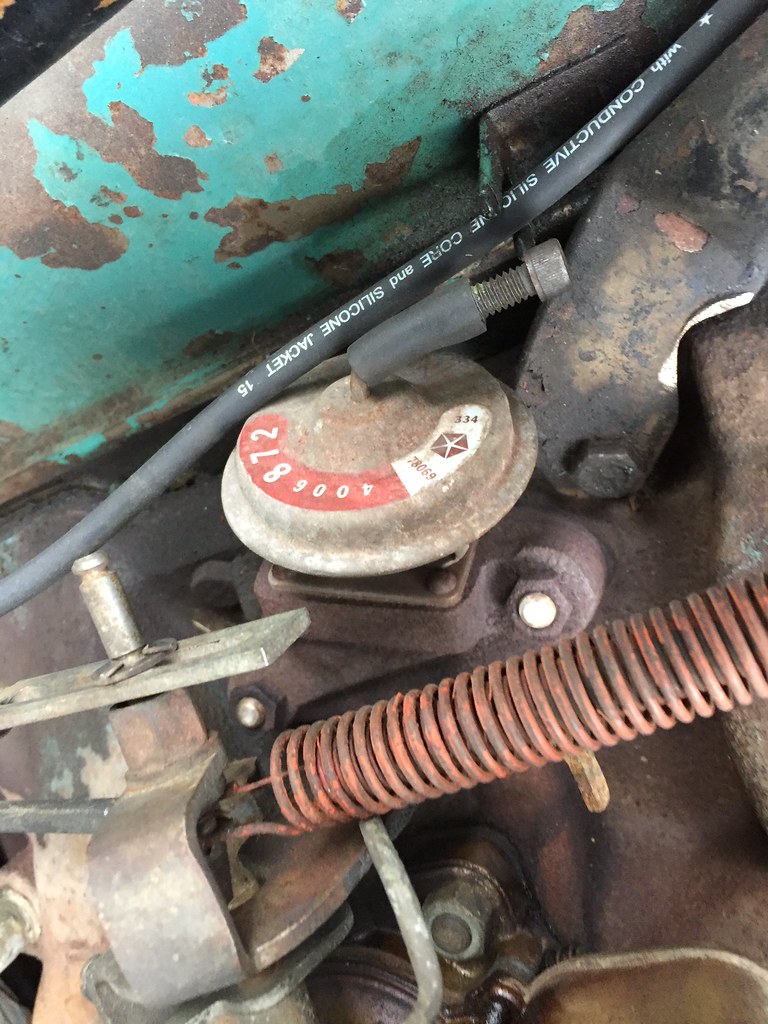

That's not a 67 intake, 73 up. Blue wire off of choke stove housing is for a electric heating element to turn choke off quicker to reduce emissions. The actual choke is actuated by a spring in sheet metal peice on the intake they are available new. The vacuum pot on driver side is for EGR valve it will make the car get better mileage on the highway if it is connected and cleaned and working properly

Hmmm. So if that's a 73 and up intake, now you've got me wondering about the engine attached to it. How to verify? Looks like I should clip that wire holding the pulloff, and see what happens. How do you properly set the choke on one of these? Press gas to floor before cold start?

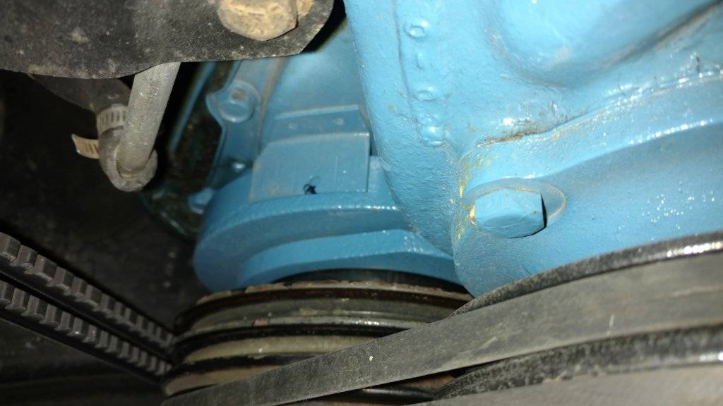

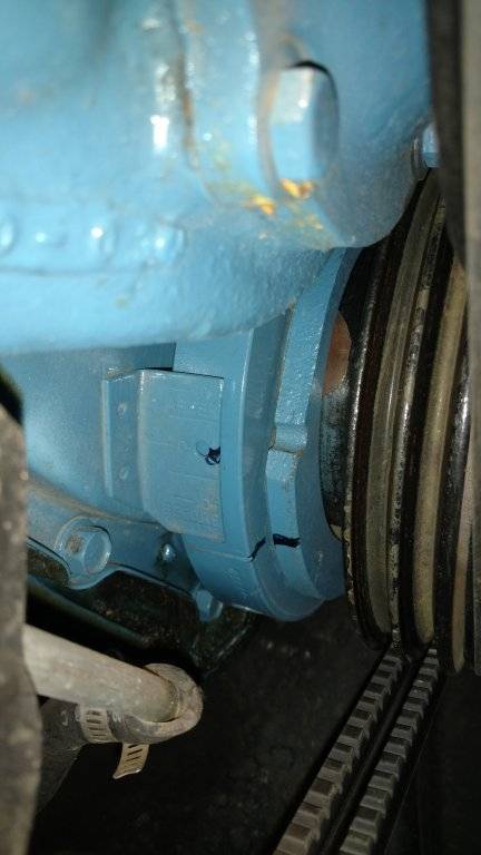

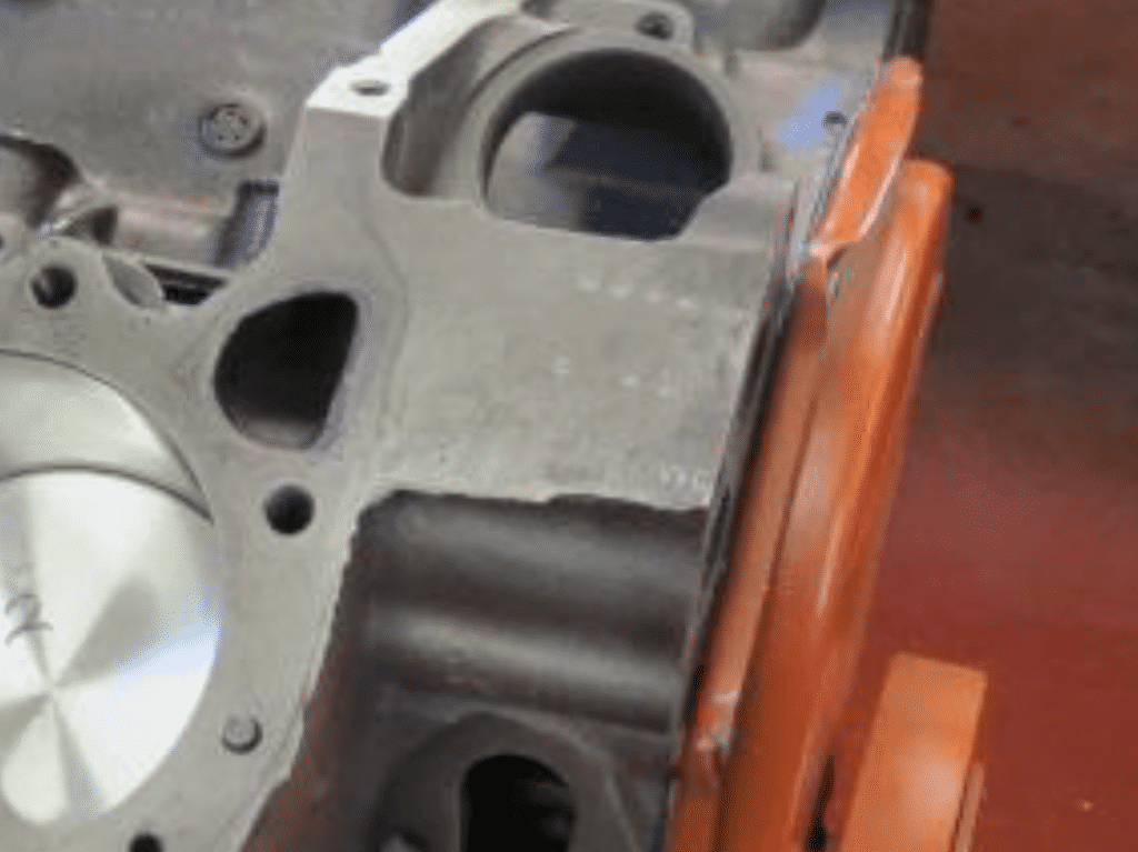

Well the intake would be off a 400, only low deck available in smog era and 440 never had 2 bbl. Check the vibration dampener if it looks like this it is a external balance 400, note the egg shaped inner hub, and or check the machined pad in front of the cylinder head mating surface behind the alternator.

If the rest of the engine has remanents of turquoise paint on it like the valve covers it's most likely the original 383 it came with. This location on your engine will definitely tell you what you want to know.
The whole engine does haven turquoise paint on it, however the casting number above the starter on the block indicates it's a 400 correct?

Nothing wrong with a 400 will run on crap gas and that intake plenum volume is bigger than the 383 2 bbl. Seems like someone did a nice job of keeping car looking original under hood but I would still pull the cover off the front of transmission and rotate the torque converter to make sure it has the external balance weight it most likely needs unless it happened to be from a manual trans vehicle. You need to do some checking to make sure you don't wipe out the main bearings. Look for a E on the upper right corner of the pad Matt showed in his post, look for egg shape on hub of vibration dampener, shown in my post then check front of torque converter for the weight

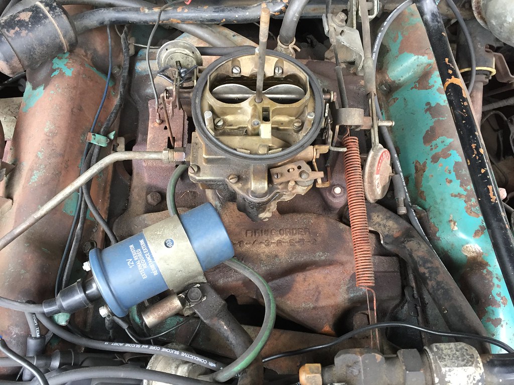

Any idea what carb is on this thing? I can't for the life of me figure out what it is...
You mean the FSM for the 75-79 car that this engine came in, or the 67 FSM that's still in the mail because I got the car last thursday and ordered it friday?
Thanks a bunch, I must've spent two hours yesterday looking at different 2bbl carbs and couldn't find this. Kind of interesting considering the Stromberg WWC appears to be a carb used on early 60's Chrysler vehicles.

I'll give you a most likely on the choke. You will need to check the choke pull off( that vacuum diaphragm that is wired open) for a vacuum leak. It opens the choke slightly when engine starts and vacuum drawn on it, there are settings for it in FSM and rebuild kit. The one problem you may have is the divorced choke stove may have longer rod for a different carb and holding choke on too long, you can probably just put a Z bend in the rod to make it shorter if it needs to be longer you will have to get creative. If it is staying on too long due to hybrid parts I would connect the heater wire (the blue one) to turn it off faster. The EGR vavle I would connect but if you don't I would pull it and block it off so no chance of a vacuum leak.
