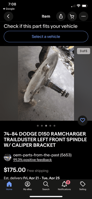

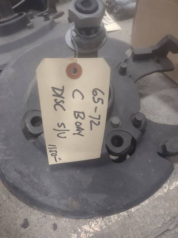

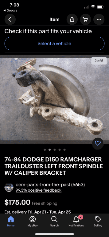

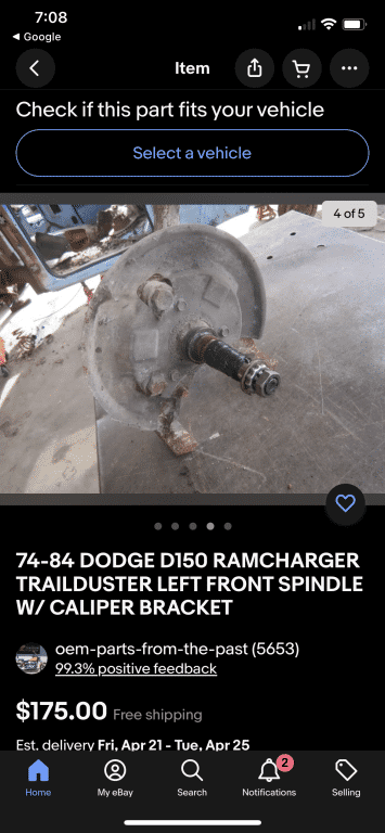

Only 69-73 calipers will work on 65-73 cars when using 69-73 spindles. Unless someone can confirm the C-body floating bracket will bolt to a 69-73 disk spindle?
I have verified that the F-M-J bracket will not - but it wouldn't fit the rotor anyway.
Some of late 70s Dodge truck rotors will fit the 1973 C-spindle - that was teh reason 73 spindles were the hot ticket, 69-72 rotors were $150 each, the truck rotor was approx $50.
Must watch that the truck rotor has the correct bolt pattern - at some point trucks went to 5 on 5".
