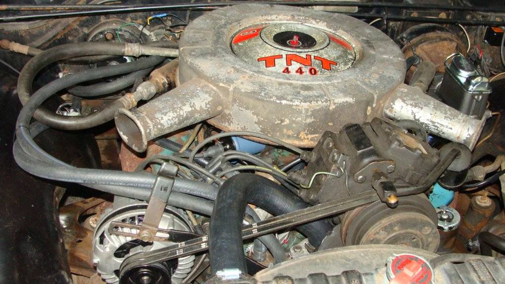

I think you have to take out the whole lifting mechanism but not the glass. BE CAREFUL when you remove the motor from the mechanism, the spring is wound up and when it lets go you can easily lose a finger! You should always put it in a vise before unbolting the motor. Nice car. Is this the one with the TNT engine?
Thank-you, yes TNT engine, 3:23 axle and original owner ordered HD suspension

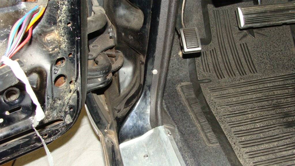

What I have done in the past is with the window up, pull the door panel off and then locate the 3 bolts that hold the motor to the regulator and drill a hole through the inner door over each bolt so you can get a 1/4 drive socket on them.
This eliminates the possibility of bloodshed from the clockspring coming unglued and makes changing the motor a 5 minute job now and in the future.
You can literally reach in through the bottom of the door to the motor with 1 hand and spin the 3 bolts out with the other.
The door panel covers any evidence of the 3 holes. IIRC a 3/8 drill is sufficient. An 1/8 or smaller pilot hole to start is a good idea.

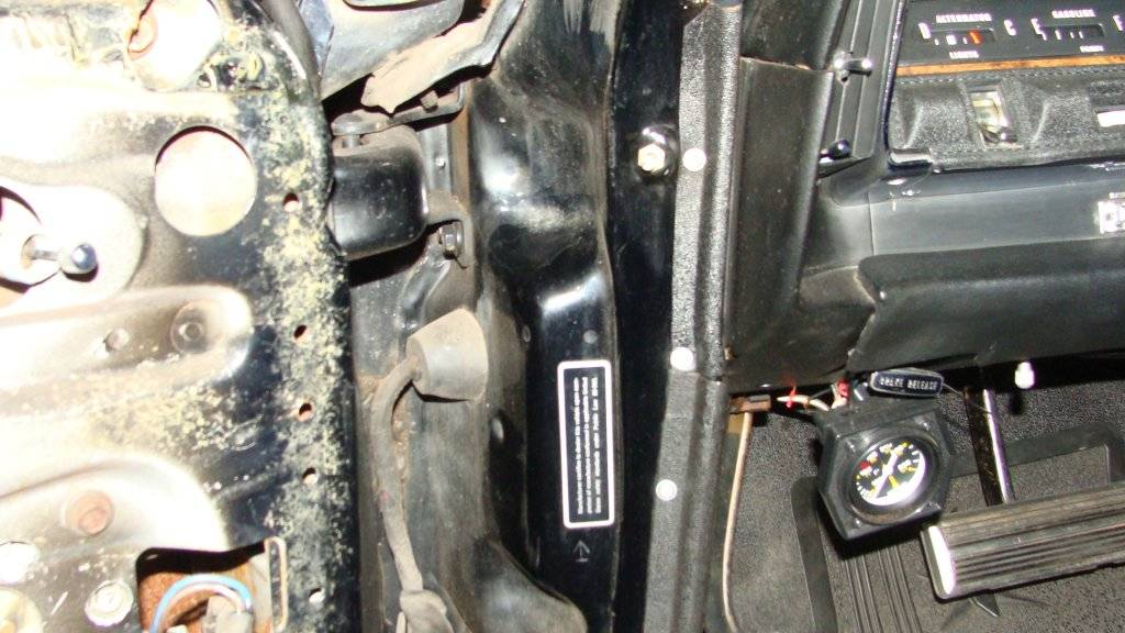

The more I examine your solution, the more I like it, any hints on locating the 3 bolts (motor) holes needed ?
You can sorta kind of see them by peering through the gap between the door and the regulator. Not a lot of room or light to see so a good small bright LED helps to put some light on the subject. Depending on how good your precision depth perception is, your small pilot holes should land pretty close to the bolt head so you can judge if another shot is necessary.
If I'm taking them out of a donor that doesn't matter, I just drill a big hole close and use some snips and a screwdriver to pry whatever clearance I need to get the socket on.
Kevin

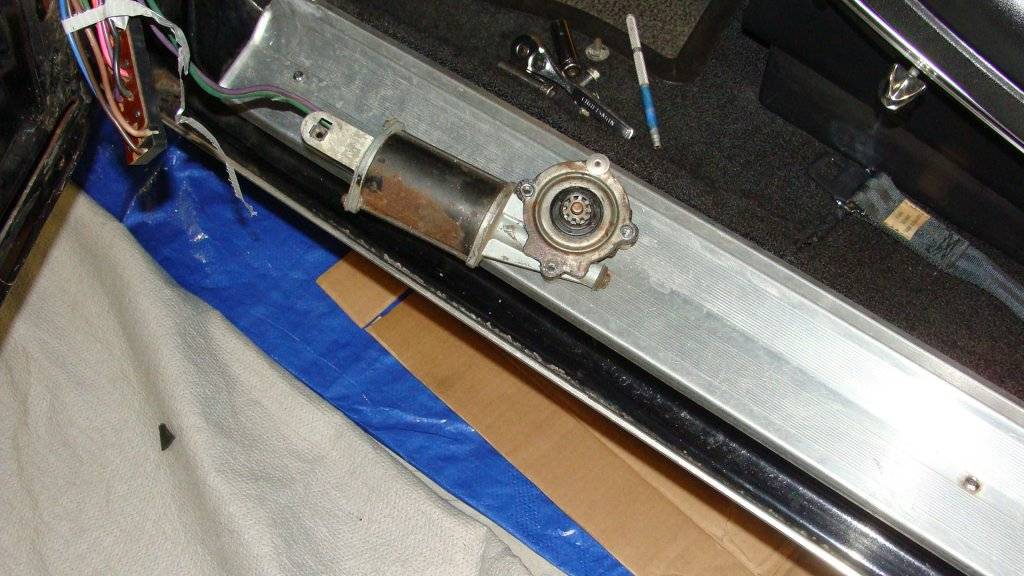

Update on PW progress; well, I drilled the 3 holes as suggested. motor came out perfect. hooked up the original switch which is still connect to factory harness. motor spun freely w/o issue. Anyone with an idea what might be stopping the window from up and down?
Remove whatever that is and take the gear cover off. You will likely find a crumbled mess inside.
Then refer to the ever famous power window motor rebuild thread for directions on the easy fix.
Also, see if the window can be lifted up and down by hand. If it's binding in the tracks and/or the regulator roller is toasted that could overpower the motor.
If the gear on the motor spins you need to replace the regulator because the teeth are probably worn or missing creating a dead spot.
Looks to me that someone has already removed that motor once, hence the rivet. Should be a screw holding the little cover plate on. While you have it out, take the cover plate off and check out the rest of the gears and pucks inside. Could be just enough shrapnel left to spin the outside gear, but not enough oommph (real word!) to raise the heavy window. While you have it out, clean it up, rebuild it and fill with grease. Lots of info on this site to do that. Also, check the roller is intact and hasn't come out of the tracks or is binding in there somewhere. BTW, Thanks for the photos for the location of the holes to drill, I am about to do all my windows. Very helpful. C Shaft
glad the pix helped, I'll take it apart tomorrow and inspect the regulator for damage
