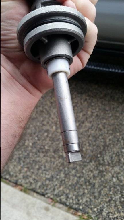

How did the "tang" on the cardone dizzy you got look? I got 2 from AutoZone & they were crap - wouldnt fit. Ordered 2 from O'reilly's to check on quality. Here's a comparison photo of the 1st one I got from AutoZone and my orig.

"tang" the end of the dizzy shaft that inserts into the cam gear. The shafts end is "male" cutout, the cam gear is "female"

Here's a photo of the "tang" of the dizzy from Autozone on the LEFT vs my stock dizzy
Ordered 2 from O'Reilly's and picked the better of the two - Much Better!

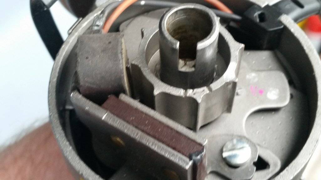

This is the part that concerns me. The reluctor and pickup. I don't know if you can tell by the pictures, but the pickup doesn't look "square " with the reluctor.
That's how mine is also - tilted a bit. The top has a bit more gap than the bottom. Just make sure you have the .008 air gap and it should be fine. Check all the reluctor stars to make sure they all clear the pickup. I'll install mine Sat.
A38E86D32, As I posted in #23 I got a cardone dizzy from AutoZone and the tang was mucked up. I ordered another and 2nd one's tang was better, but the pick-up was not new. I went ahead and ordered two cardone's O'reilly's and picked the better of the two. The tolerance of the reluctor and pick-up on the two units from AutoZone looked exactly like yours so I assumed that's how these all were. After seeing your post I took a look at this O'reilly's cardone and the reluctor & pick-up are indeed parallel to one another. I'm thinking AutoZone has some crappy stock so I'd say it may behoove you to try for another. If you have an O'reilly's out where you are I'd try ordering a couple and see what you get.
