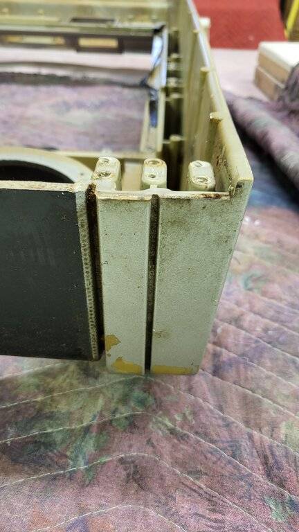

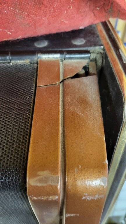

Here is what I got. The is a design flaw in the upper area of my big jukebox door. I damaged mine and was able to buy a donor door and want to reinforce this area.

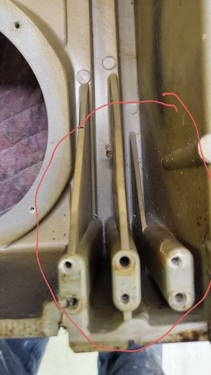

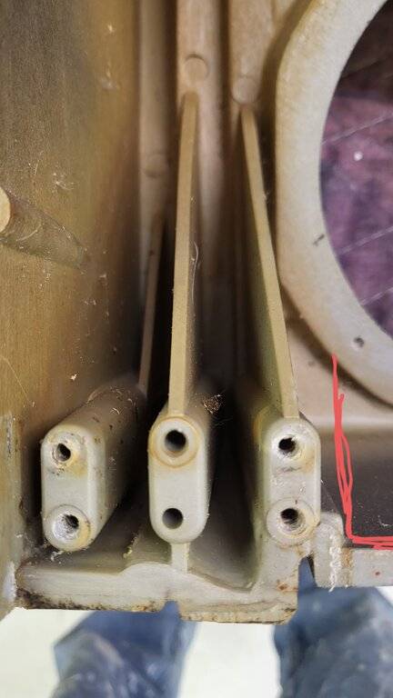

Hear is my idea. I don't want to drill into anything. I have thought of cutting pieces of aluminum and using JB Weld to adhere it to the surrounding plastic.
In addition to this is there any epoxy which I could then pour into the void to reinforce it even more?
Circled area to reinforce.
You can fill the area with J-B weld. Once it’s cured, you can grind it with a Dremel tool to your liking.
I reground a water softener cam after filling it with J-B weld and it worked perfectly.

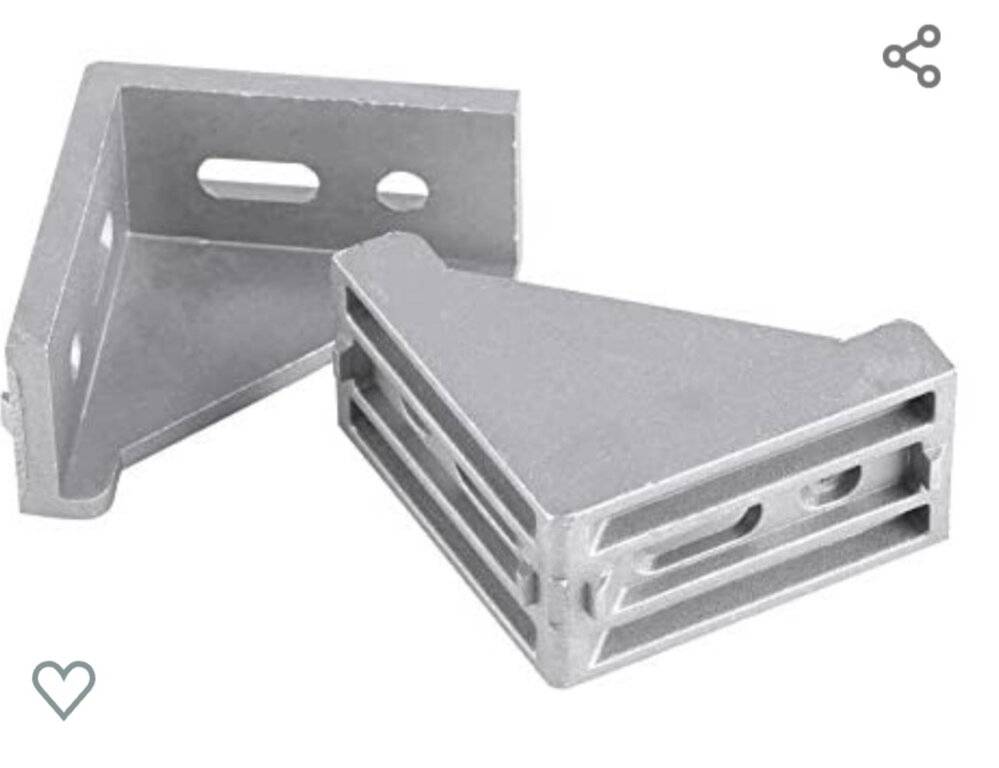

Thanks, what is your thought of setting this aluminum bracket in JB Weld. This is an area which needs reinforced
This is the bracket I was going to use.
