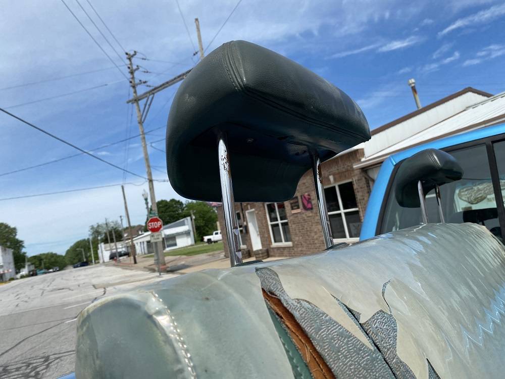

What are people doing when their headrests get cracked? Is there a solution or aftermarket replacement that will work? These are not fabric but molded around foam like a dash.
I guess its similar to dash cracks. You either get it recovered or settle for some band aid that's good enough. Legendary makes headrest covers (not sure about those exact ones) but even if not its a small project for a professional. As far as patching goes there are a ton of "fixes" for vinyl and leather - cars and home furniture. My bench seat headrests were cracked in a few places, and I used the old school vinyl patch compound to fill in the cracks. Had to add it in several layers. I was surprised at how well it held up. You could easily see the patch but much better than tan foam color. I've also used black RTV silicone for small cracks and also Roof Polyurethane that also works well as seam sealer. All of it can be seen though. I did try to use vinyl cement and a watchet strap to close the cracks permanently. They did not stay closed :(
