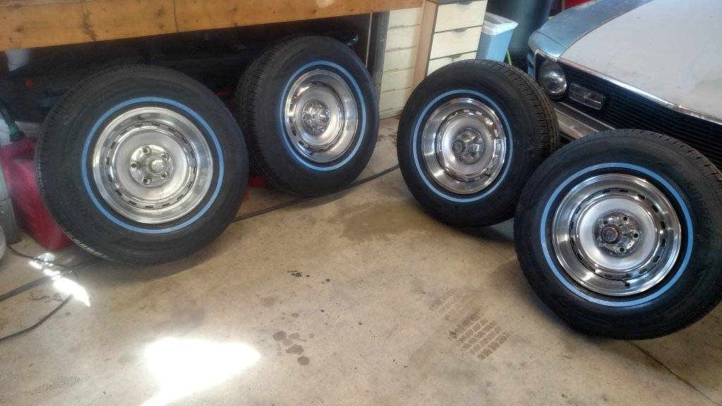

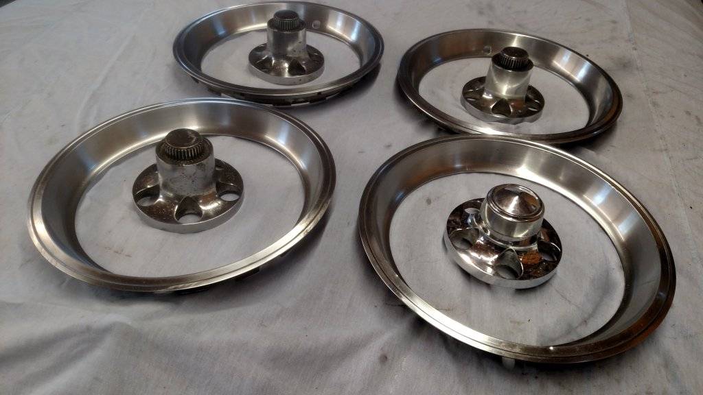

I just taped them off, when I did a set. Was years ago, but I don't remember it being very hard. Worked well . . .

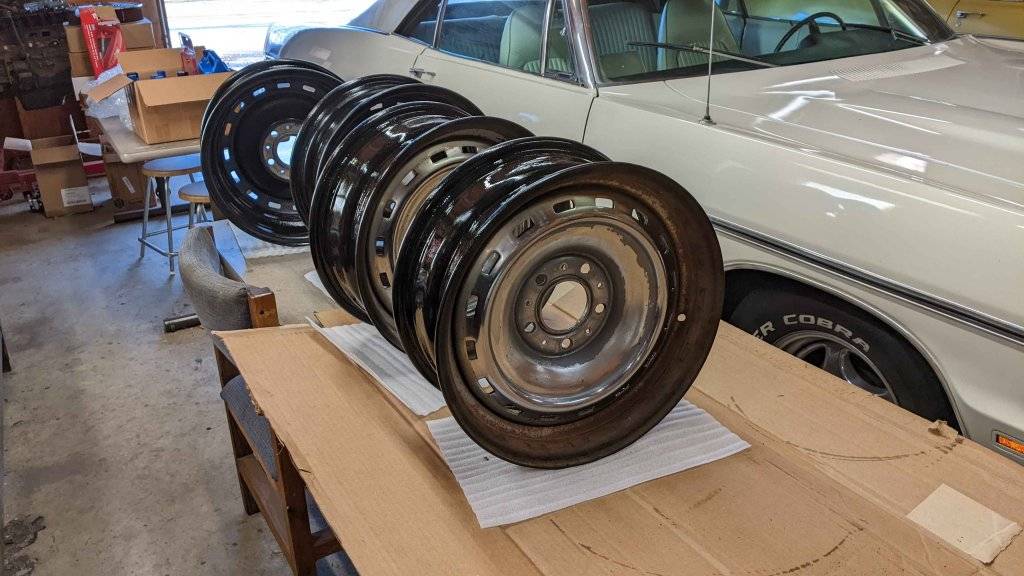

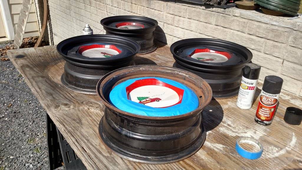

I used duct tape prior to prepping for paint to protect the chrome finish. Doing that gives a better overall appearance. Choice off paint was extreme heat Rust-Oleum Paint silver and Rust-Oleum Matte Black for the rims. What us see below was applied in 2017. Very durable.
Another option is to paint over the chrome and with a damp cloth (lacquer thinner) gently rub it off the chrome only. Paint comes chrome easy. Even easier if its only been on there 24hrs or so. Make sure you change up the cloth to avoid paint buildup and for sure don't put too much thinner on to avoid drips. For small areas I have painted over and removed the paint i didn't want with the back of exacto knife. Like the rear ash tray lids. Painted the back without masking and rubbed off the overspray. This is too big for that but you can easily straighten the chrome - paint line with this same hard straight edge. With practice you may be able to produce the feathered effect by using even less thinner and little more force which will clear only the top of the chrome trim.
I am going to put road wheels on my 1970 Plymouth Fury convertible. I bought a set in South Carolina and am starting to paint them to get them ready. So far I am using POR 15 gloss black chassis paint on the rear and sides. I know the center front should be Argent Silver. Are you all just taping off the chrome area so you can go ahead and paint the front of the rim in Argent Silver. Or do you make some kind of pattern and cut out the material to cover the chrome. What you think the best process is for painting the center? Thanks
Current rims have rust, not visible

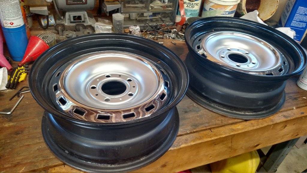

Here ya go. . .
