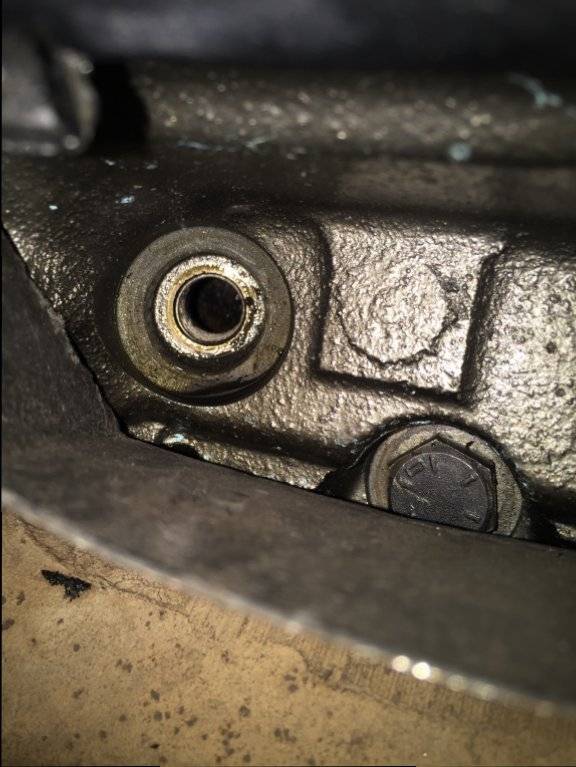

Now that we're talking about intakes and oil, I've always see a little oil pool between the intake and heads, in the gap between the carburetor and the bottom of the intake and in most of the spark plug holes I can see a little oil pool. Can this be related?

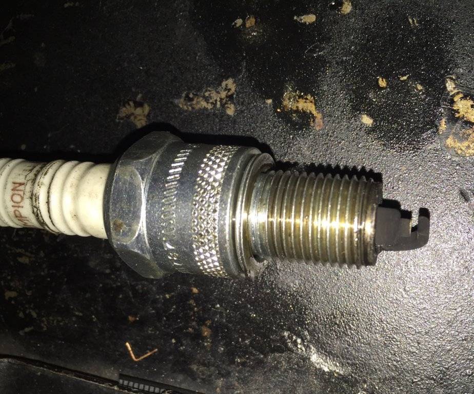

Yesterday I checked for oil in the rear of the engine, I didn't find a clear or big oil leak but some of the RTV sealant that is in the rear of the intake has some oil on it, also take the chance to check the spark plugs and none of them has traces of oil on it, them are only black (check attachments) and also I took a picture of the small oil pool in the plug ports, I don't know if it has something to do with burning oil just after wot. I forgot to inspect if the PCV has oil on it, I'll do it today and post the results :D

Those photos do not seem to suggest straight-up oil burning. The deposits on your plugs look like the result of a very rich mixture. In my experience, a motor that burns oil will leave white ash deposits on the plugs. In any event, if the motor has not broken in, you can expect a certain amount of oil burning, yes? I'm sure someone will correct me if I'm wrong. If it is occurring after wide open throttle, then whatever the problem is, it's evident during a high vacuum condition. Quite often, such problems result from valve train issues. Please keep us apprised of how this all shakes out. I'm sure I'm not the only one (other than you) who is curious about the cause.
