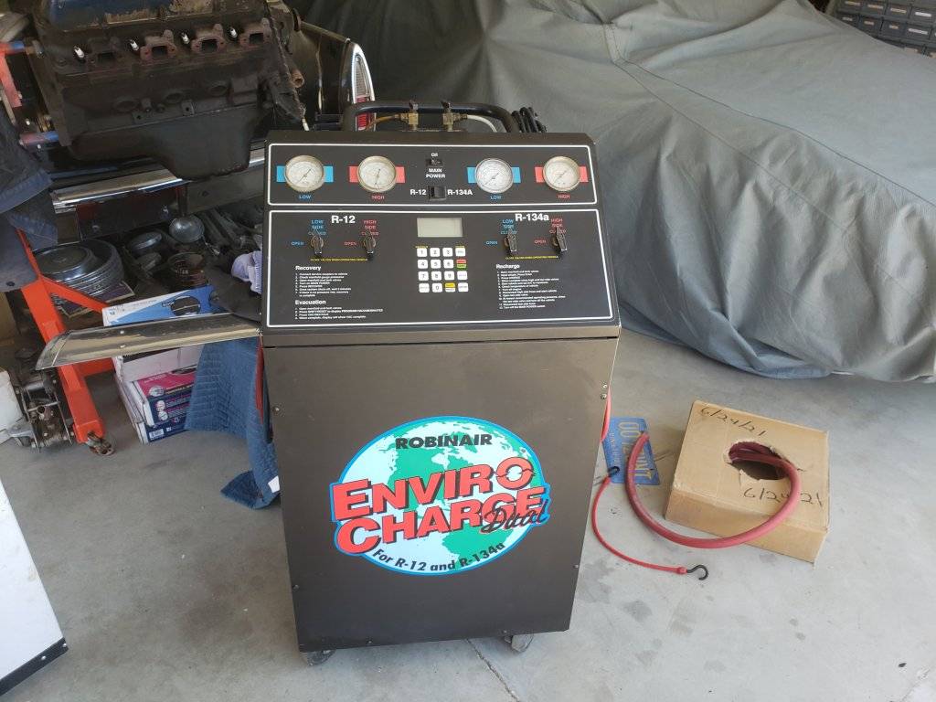

I picked this one up, had this style in a shop I worked at, always worked great. Recovers, Stores and recharges.
yeah that's much newer than the one i have...and undoubtedly worked a lot better...mine was the first generation that came out ....we were required to buy the machine and pay to go to a NY state DMV class (physically show up...no online testing back then) that taught the evils of R-12 and what was required to do a 134 conversion....once we passed the test we got a card (with our social security number boldly printed across it) that we now had to show in order to buy freon... of course any parts house that we regularly dealt with never asked to see it....
