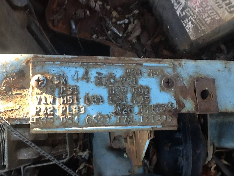

And on a 1977 tag it should look like this:
Note that there is a third candidate: H51 Manual Airco.

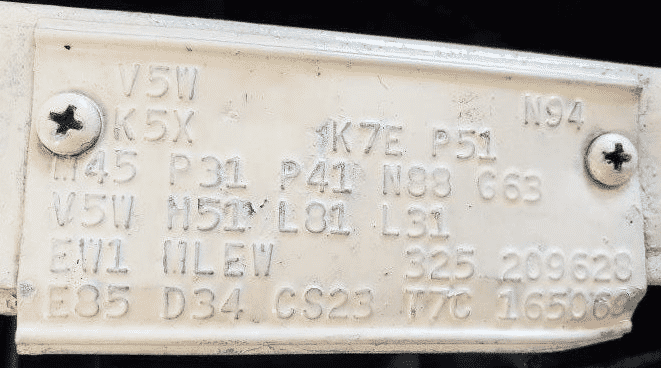

Finally got a picture to upload of the subject data plate. I concluded after further review that the mystery code is H51 instead of M51. Now you can go at it if you see anything else interesting on the tag
What this tag has in common with all 1975-1978 tags with the Crown Coupe (LeBaron) and St. Regis (New Yorker/Newport) package is the repeat of the code for the specific roof treatment, V4- for 1975-1976 and V5- for 1977-1978. It is once mentioned in the slot for the roof style (third line from below) and once in the upper row.

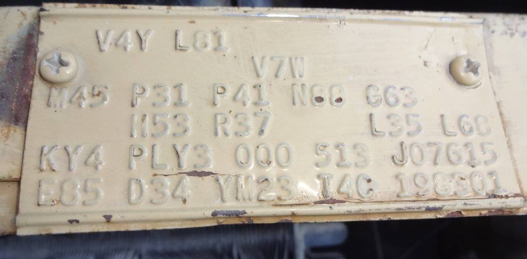

In 1974, when this treatment was introduced on the LeBaron, it was only mentioned in the upper row (V4Y) and the slot for the roof style was left empty:
