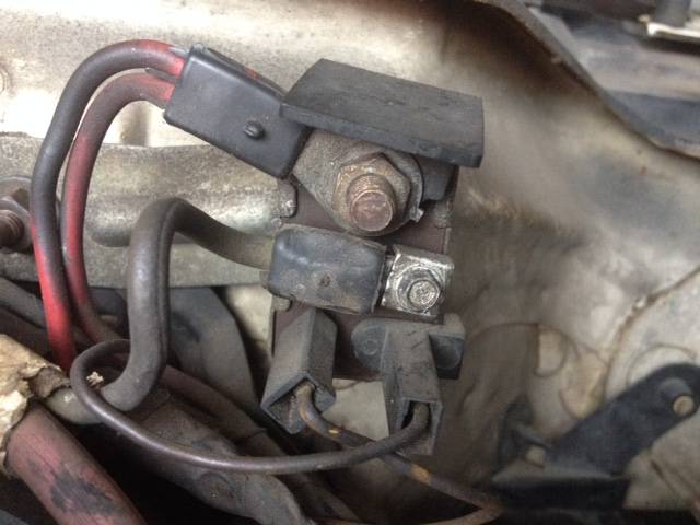

The fat wire from the starter goes to the starter relay..
Next to that terminal is a smaller wire on the relay that also goes to the starter.
At the relay stick a box end wrench onto the big terminal and the small terminal..
May spark a little don't be concerned about that...
The starter should engage (turn over)...

Test for power at the large terminal on the relay, it should look like this one
. If you have power and it just clicks go to the small wire with the screw and check for power while someone turns the key, if you have power go to the starter and check for power on both terminals (large one is from the battery, small one is from the relay) while turning the key.
Here is a pic of the relay with the wires
The neutral switch provides ground to the relay, with the test light clip on the ground anything you touch and it lights, you have power. If you put the clip on the positive anything you touch and it lights, you have ground.
I know it's lost of info, but I hope it will help you find the cause of your issue. Happy hunting
Stick a quarter between those two exposed terminals and if the starter turns over, the relay is likely the problem.

Actually, all you are doing is bypassing the relay that doesn't handle that type of current. The relay makes the solenoid in the starter work and the solenoid does two things, first it pull the starter gear into the ring gear and then it makes electrical contact that makes the starter turn. The current passing through the relay is just for the solenoid and not for the starter. If you've ever had a starter apart, you'll see the large contact under the screw terminal.
It's nowhere near that amount of current at the relay. The quarter gets a little warm and will get hot if you leave it on too long. Key rings get hotter LOL..
That said... If you aren't comfortable, that's fine... Use a screwdriver.
For "not that much there", it sure does make a solid spark with a screwdriver end. Just don't be bashful, make that contact firm, quick, and with authority.
