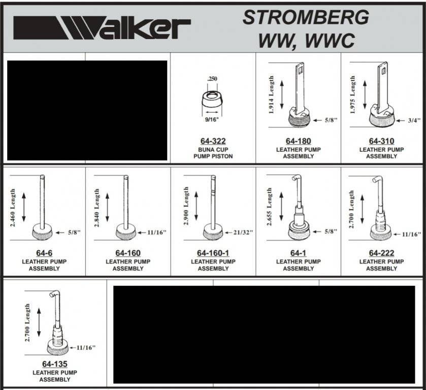

My '67 VIP has a smog-era 400 in it with a Stromberg 2bbl. I rebuilt it and got the choke working. Car starts on the button and runs fantastic. The ONLY exception is WOT from a dig. The car dies when you floor it. Immediately I'm thinking that the accelerator pump isn't working or the squirters are clogged.
Then I found a post in this thread:
Stromberg Carb Swap
With this:
picsart_04-07-09-41-17-jpg.75407
And I'm wondering if I just have the wrong accelerator pump assembly in my carb.
Mine is technically a Stromberg WWC 3-276. This is the kit I got, which specifically lists the 3-276 model number:

I've never seen a rebuild kit that had the correct pump for my Mopar Stromberg. They all came with what looks like the GM Stromberg pump.
Thing is, my Stromberg has a square post accelerator pump rod. The lengths of those seem to be specific relative to the bore size. I.E. only one specific length...
Is there a position or adjustment on the carb itself?
*edit*
The tuning instructions talk about bending the pump actuator rod. I'm wondering if I can tweak it there or put it in a different slot to get a better pump shot.
