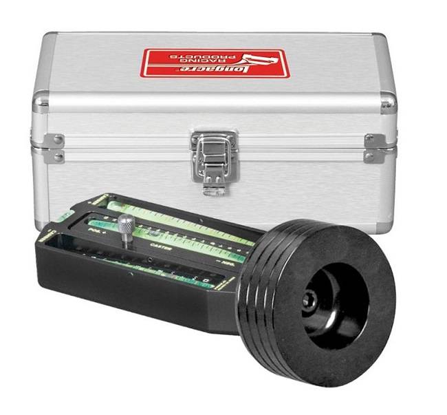

I am so impressed I bought the tools and will try this out. :steering: Longacre Racing Products 52-78260 Longacre Caster Camber Gauges | Summit Racing Longacre Racing Products 52-79501 Longacre Toe-In Plates | Summit Racing
Close but there are a few angles that this set doesn't measure.

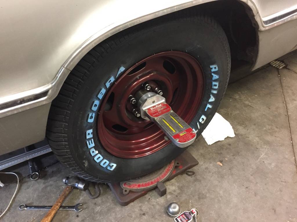

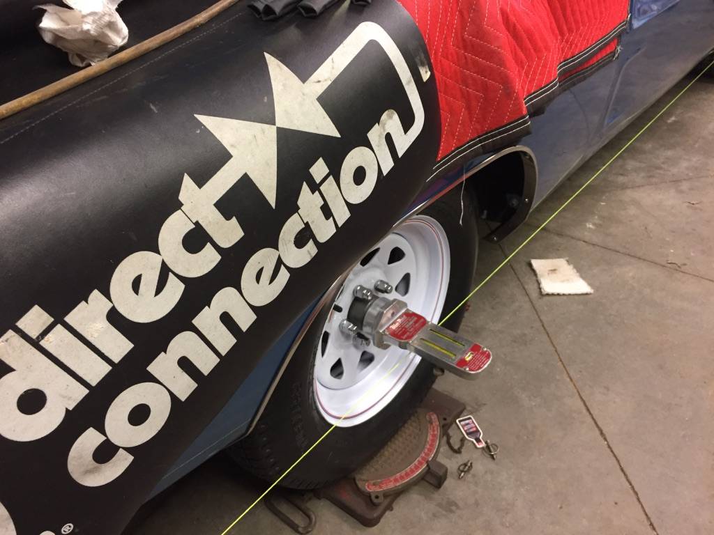

I have been doing my own and clients alignments for years with my Snap on/ Blue point gauges, turn plates and string. Hardest part is toe on your own and power steering. Shops just want to set toe and go, the operators really don't know much else and if they will take a classic, it is called custom work and you are paying $$. Then on they way home you curse at the shitty expensive off center steering wheel and pull. I like to use the trailer wheels, as the gauges will not mount with the Magnum 500 wheels or any wheel that covers the hub.
Car has to be at right height, so I add equal to turn plate thickness block of wood under rear tires. This is for correct caster reading. Set up can be tedious , much easier with a helper to move string in and out, but some help can be worse than none.
Also with Birdsong's method of turn tire full lock to lock is not how I was taught to read caster. I turn the wheel 30 deg front in zero gauge, center wheel and take reading. I guess if you don't have a degreed turn plate going to lock keeps you consistent.
