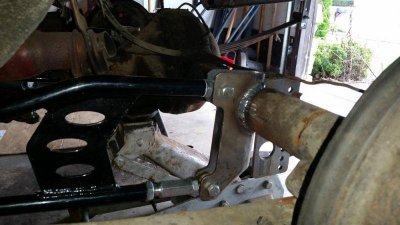

Ladder bar to rear axle

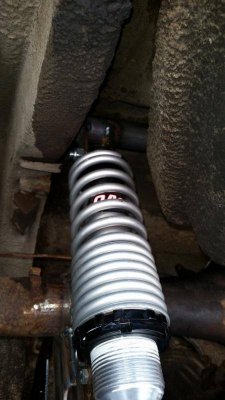

Coil-over and shock crossmember
Coil-over to axle

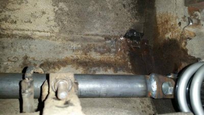

Another shock of the Coil-over crossmember. I cut a hole in each side of the frame rails with a hole saw and then slid the bar in place and welded it. Doing it this way adds a little strength. The attachment brackets for the gas tank straps interfered with the crossmember. I carefully modified the factory gas tank strap attachment points to retain the factory fuel tank.

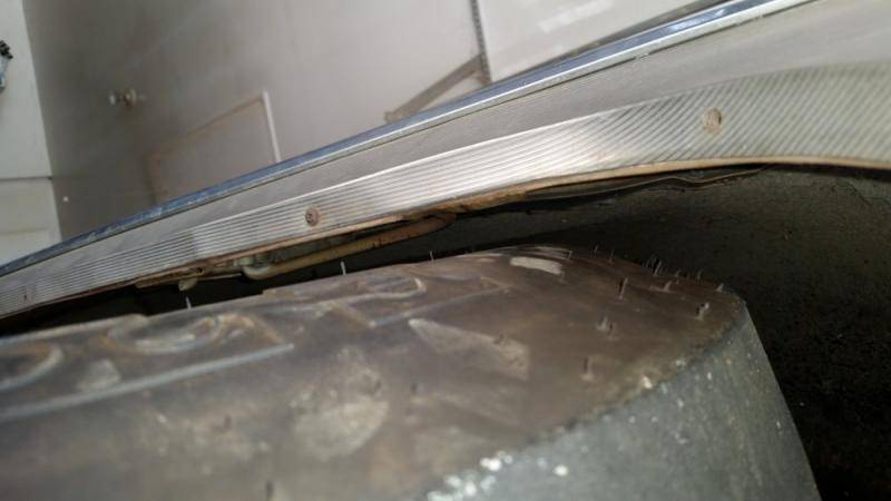

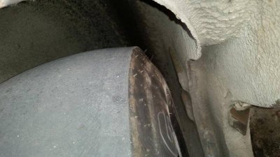

Although it doesn't look like it in the picture, there is 2 inches of clearance between the tire and inner wheel well.
There is an inch of clearance between the skirt and tire. I'll gain a little clearance when I change wheels but might have to roll the lip a bit. These wheels are just test wheels. They are 10 1/2 inches wide and I'm going with a 15x10 and a 325/50 drag radial.
