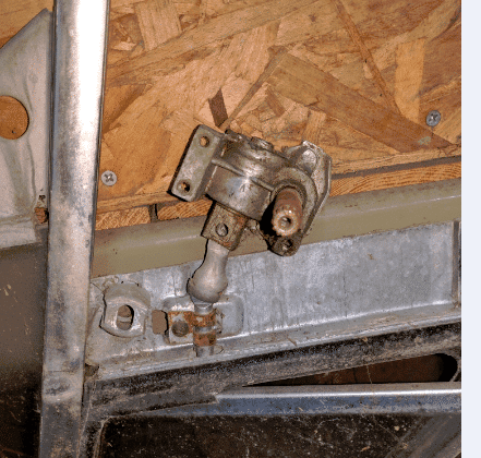

i need to replace the vent window crank mechanism on my 65 savoy. i ended up busting the glass on the car i got the replacement mechanism out of so it was not too difficult. however, getting it back in might be a different story.
can anyone tell me if i need to remove the glass to replace the mechanism?

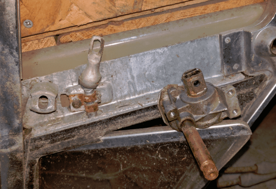

The shaft on the glass has a ball type socket on it, just below that is a bolt, separate the regulator there.
Alan
The window is upside down so ignore that part, or flip your monitor over. First shows regulator sitting on the shaft, bolt removed; second shows regulator sitting next to the window shaft.
