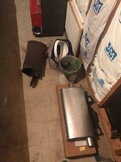

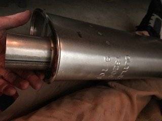

I just got a Walker SoundFX 18200 muffler, and went to install it yesterday and ran into a possible issue. This muffler was set up and intended for my application.
The pipe that is closest to the stamped "outlet" words is actually the inlet (from the engine).
The muffler doesn't work when installed the other way. As shown in my first and second picture, there are indents in the outer skin, which made me believe that the inside guts are directional. Could the outer faces have been welded on the wrong side?

I just got off the phone with the tech department at walker muffler. I was told to disregard the outlet stamping. It's placement has been an issue before.
Just install it with the inlet as the offset, and the outlet as the center pipe. This is also confirmed through the pipe diameters, since the inlet is wider than the outlet.
