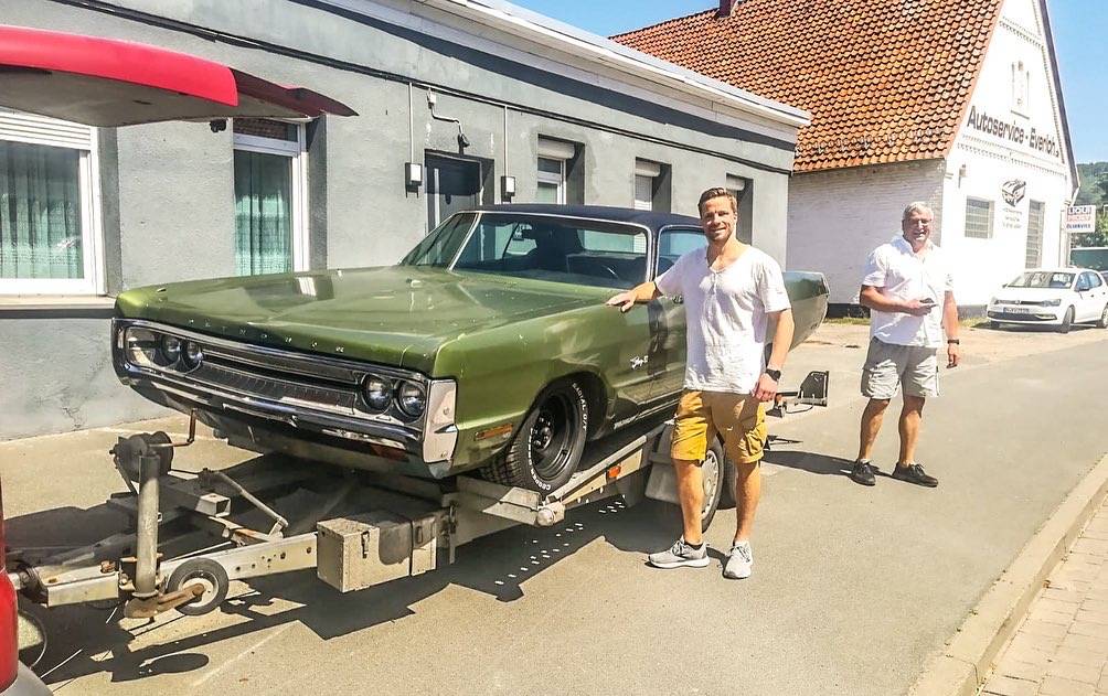

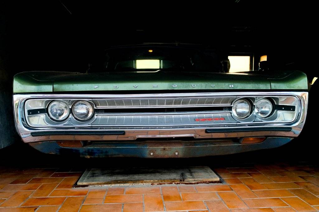

I would like to introduce myself briefly. my name is benjamin, i come from hesse / germany and since 15.05. owner of a 71' fury III 440 hp.

Welcome from Southern California. Nice car and with a 440HP no less!
Welcome Benjamin!
Nice car you have there. I would like to meet you and the vehicle live.

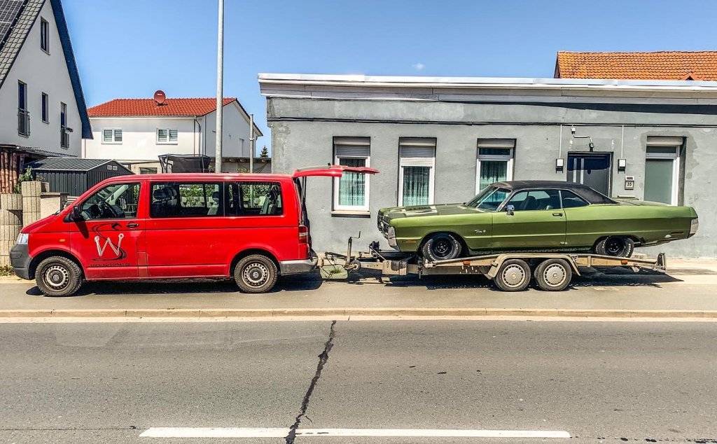

I brought the car from a member here as an non running project car and brought it back to life, i picked it up in Idaho Lewiston the car was parked in 1981 due to transmission failure.
It was originally an 360 2bbl car and I think the first couple years an Hertz rental then someone brought it and installed the 1972 440HP engine with super low gears when I drove it the first time it was no fun at all 4500rpm at 60mls or 100kmh, your vinyl is not original to the car it got added on at one point.
You should have some old pictures that came with the car.

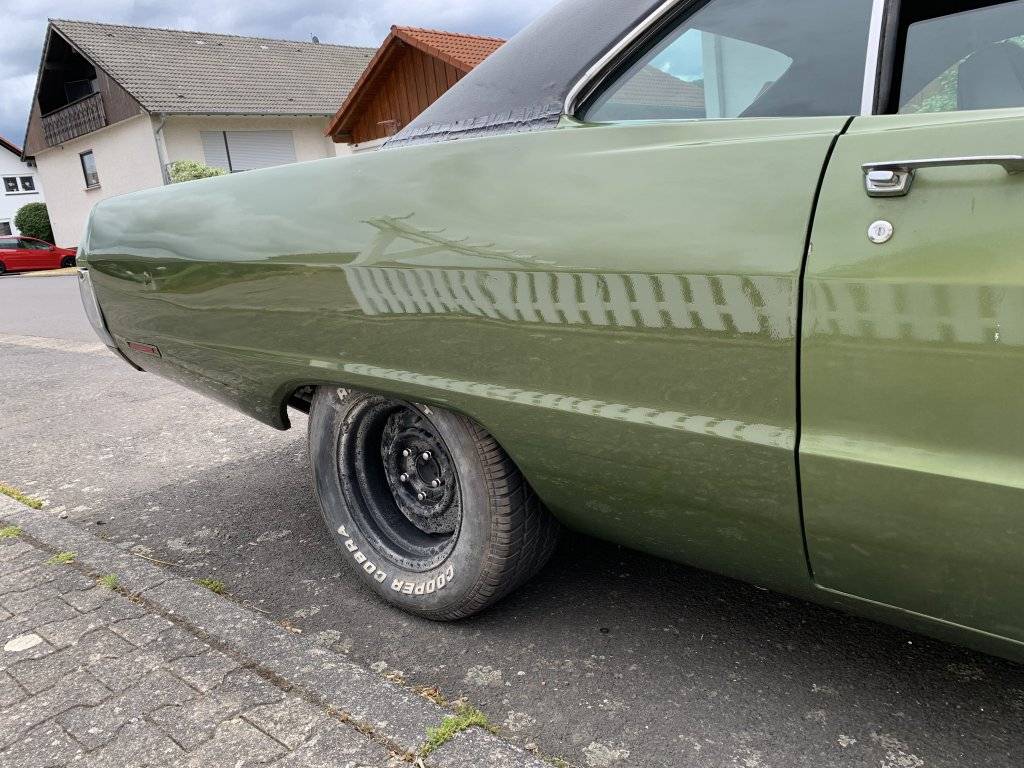

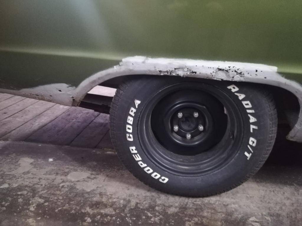

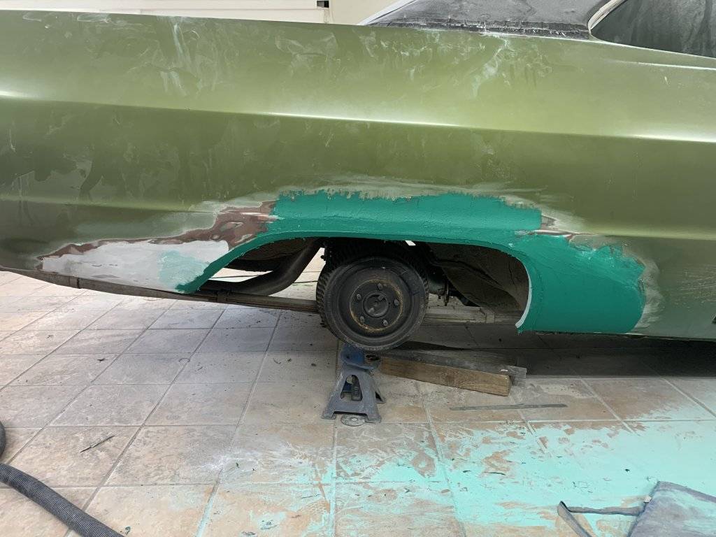

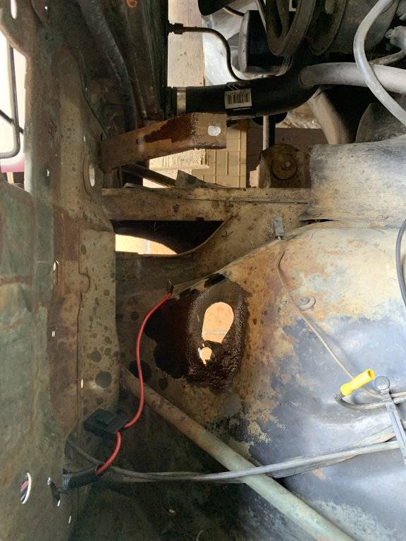

The Rust has been removed. A metal sheet welded in, filled, primed and painted.

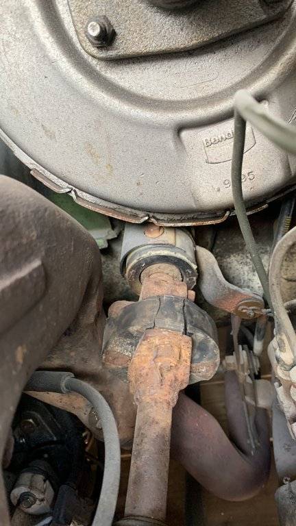

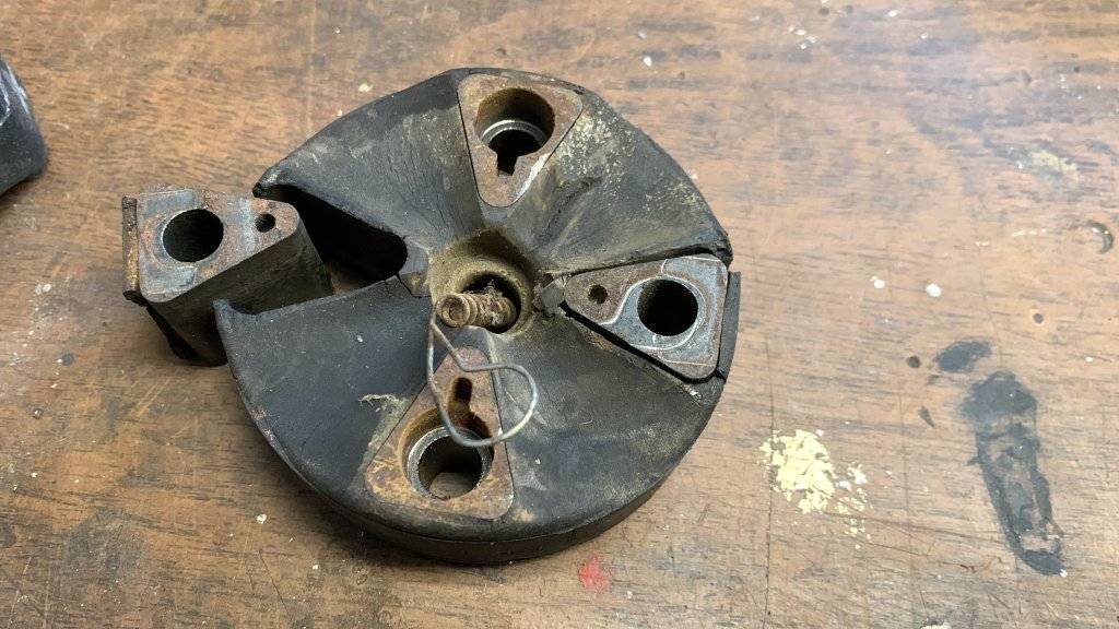

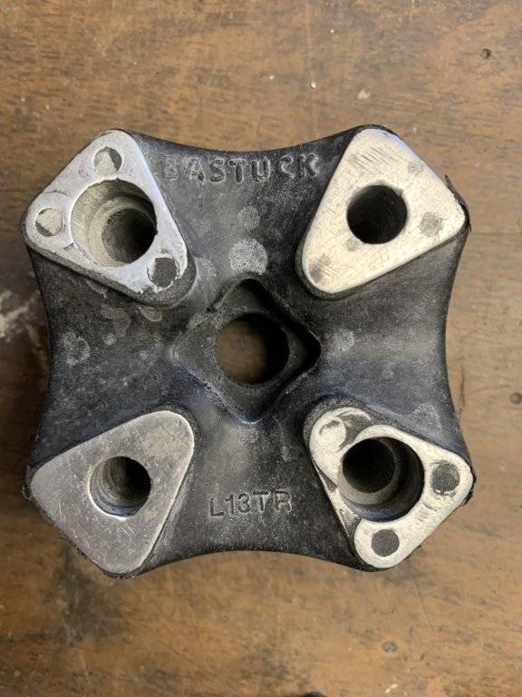

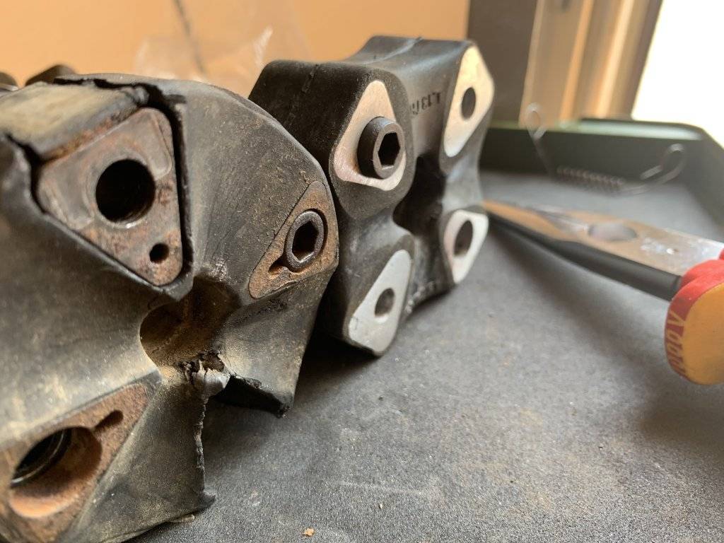

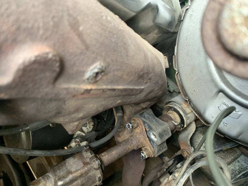

The Hardy-Disk was destroyed. This was replaced. Since there was no Origina, it had to be improvised.

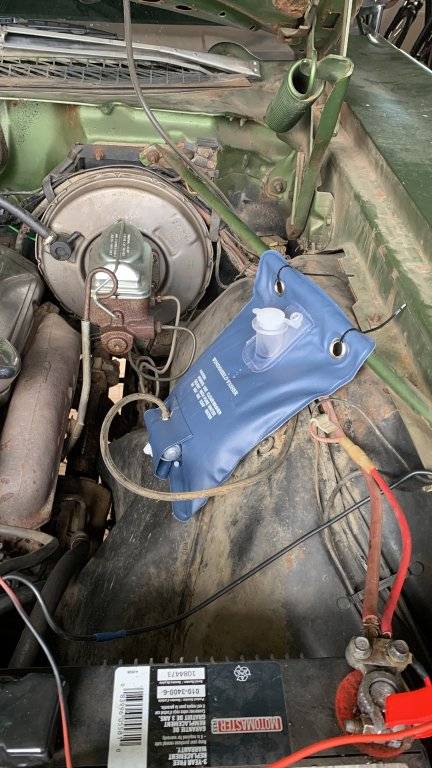

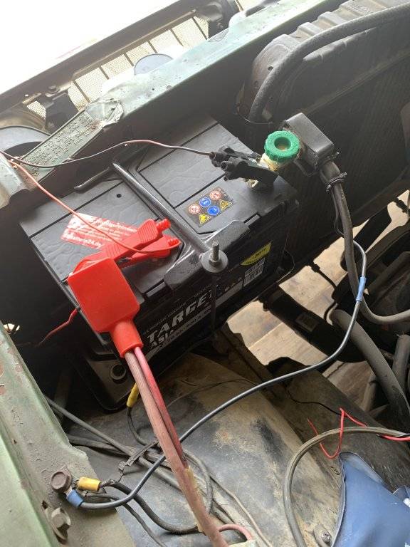

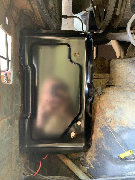

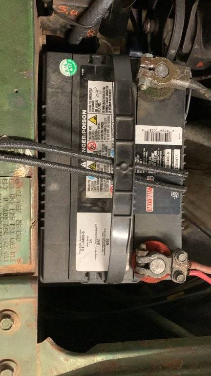

The Battery Plate and the Holder have been renewed. As well as the Battery. For the technical Inspection I installed a provisional Watertank with an integrated Pump.

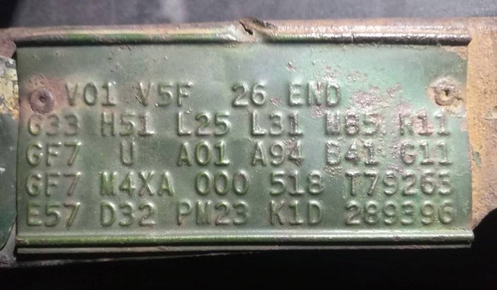

@BE_Fury abd @Tobias74 — Is this a GJ4 originally, GF3, or a darker green that was painted over? The tag would help.

Interesting.....a T-VON. I have and know very little about these letter von's. Learning. @69CoronetRT can you help inform me about the T.
Cool car @BE_Fury . Looks to be in really good shape!
