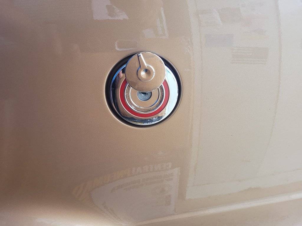

Will this locking gas cap fit 1960 - 1966 C body wagons?
ZooKypr
Apr 6, 2013
37
6
NJ

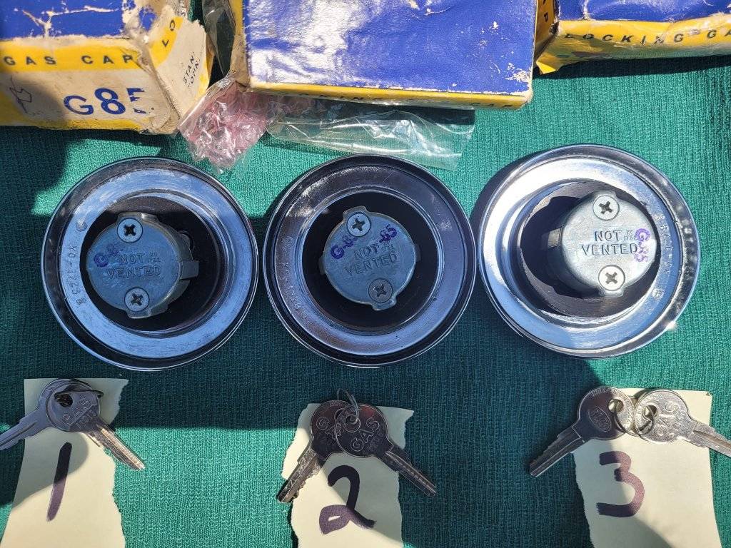

Sorry, I don't post much here, I'm an early A owner but always admired the C-body land yachts!... Anyways, I was advised by a member of a Facebook group for Early A bodies that this hidden key hole gas cap will fit 1960 - 1966 B & C body wagons. He mentioned it should since you do not rotate to lock / unlock these caps put you push them in and they lock in place. They do fit Early A-body 1960-1966.
I cannot find a catalog nor any info on Stants website. I even tried calling them and refers you back to website to fill a request out, which I did but have not heard back.

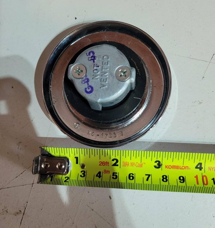

Its a Stant G-85
non-vented locking gas cap with a "cool feature" of a hidden keyhole. If it fits B and / or C body wagons I will be listing them for sale here.

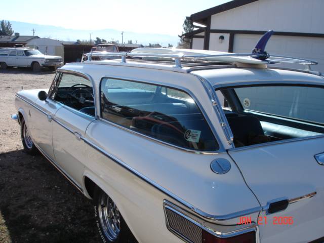

Give me measurements. OD ID and OD/ ID on the lugs. I can chk against my 64 .60-64 sit in a recess in the top of the 1/4 panel.

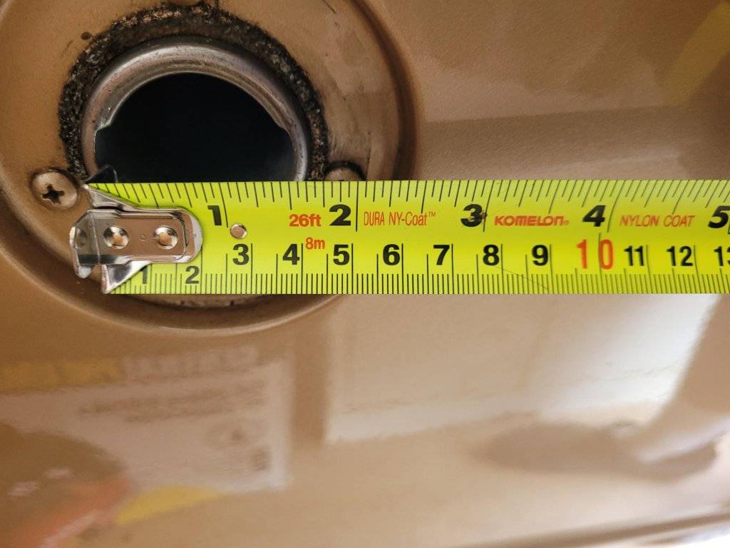

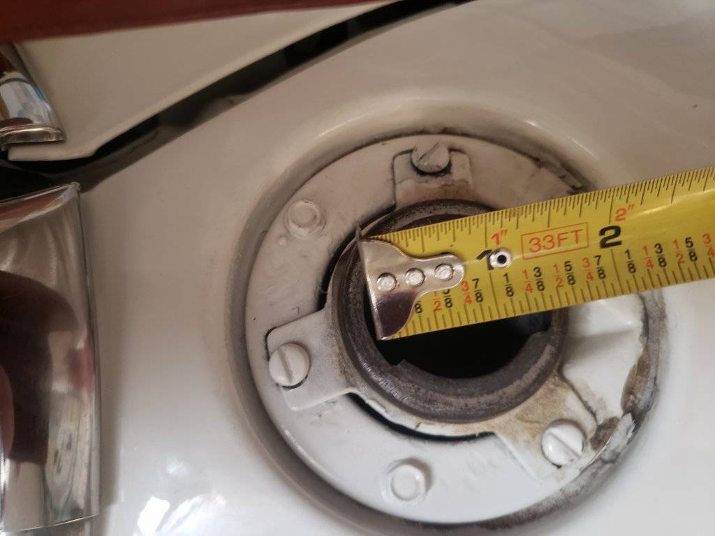

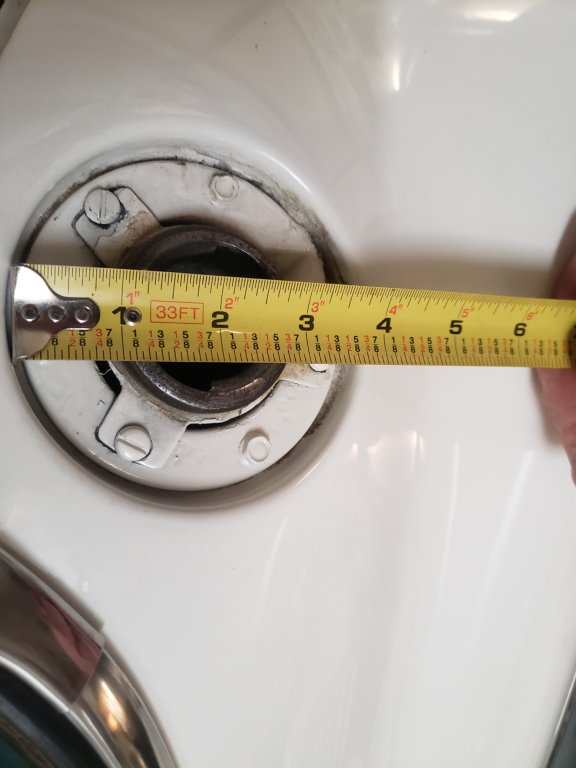

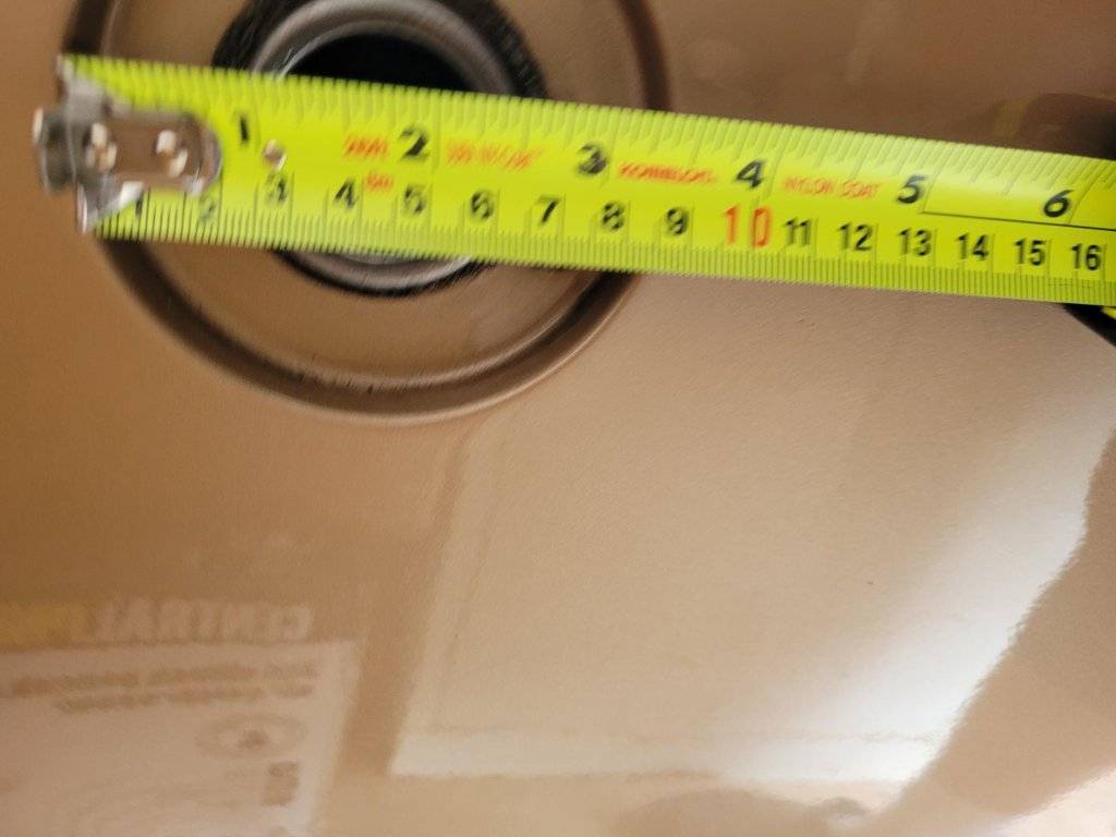

I attached some pics with dimensions.
Looks on the fuel filler inlet its 1 1/2" from notch to notch.
Gas cap opening on quarter panel is about 3 1/2"
Back of gas cap slot to slot that insert to fuel filler notches measure 1 1/2"
Overall gas cap is 3" wide.
Hope this helps!...Let me know.
These are all one-handed pics, if these do not work next time I have a extra set of hands I'll get better ones.
Looks close but I think my gas cap is slightly larger. If you got time, can measure the backside of your gas cap? That may clarify things. Thanks!
