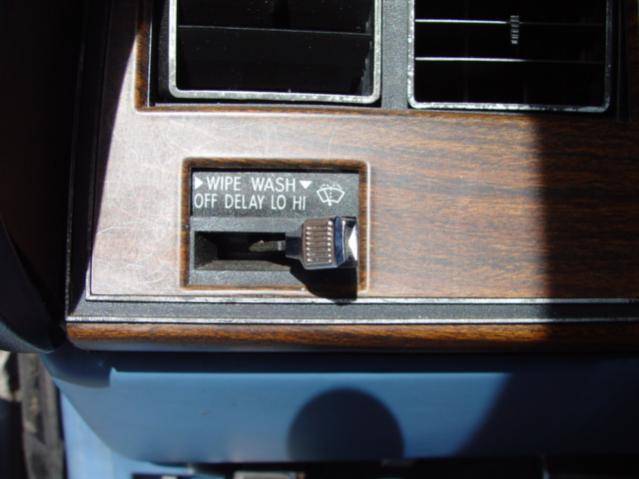

Bob:
I'm working on the best solution for you guys with the '78 windshield wiper problem. Through the help of two other NYB owners who have worked on their wiper systems (one a 77 and one a 78) we are comparing notes.
I need one thing from you first:
Please give me the measurements of the fascia opening for your wiper switch as shown in the pic because we're coming up with two different sizes for 78 based on whether it's a 2 speed, 3 speed, or varable speed wiper system.
Width = 1.75" Height = 1.25" My 78 NYB is a 2 speed intermittent wiper system. The wiper switch is part number 3747 350.
Thanks Stan!
Good. Looks like a 2 speed or 3 speed switch (of which there are ton of, used and NOS) is a plug 'n play.
I'm waiting for them to get back to me on what hassles there are under the cowl.

Hi.
My is the same as Bob's NYers.

Hey, good news.
If it helps, it's been confirmed that your 2 speed delay system was also used on the 79-81 R models.
Maybe Murray has a few of those around.
