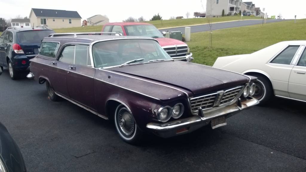

Progress of restoring my 63, doing absolutely as much of the work as possible.
General Information

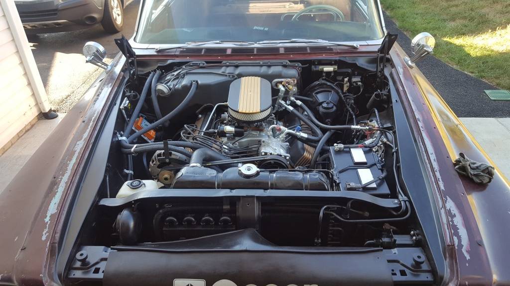

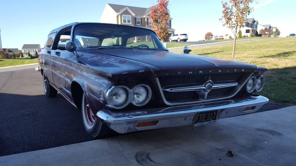

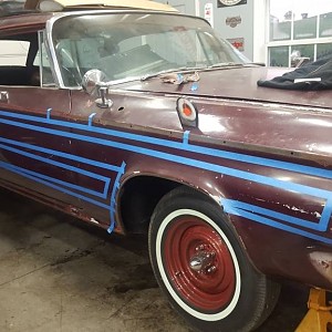

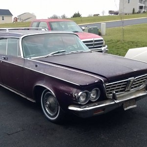

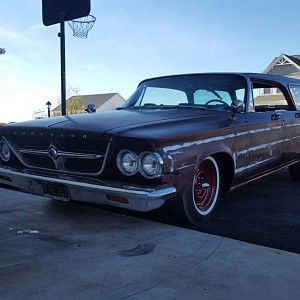

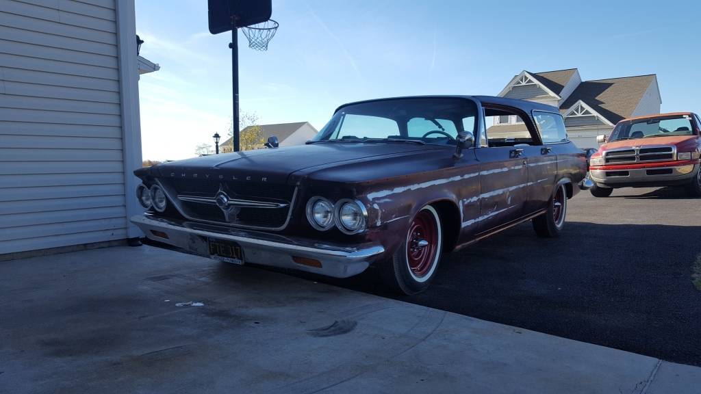

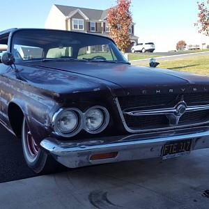

I've attached a few pics of my 63 wagon. I'm new to the forum so bare with me if I ramble.

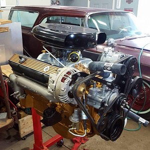

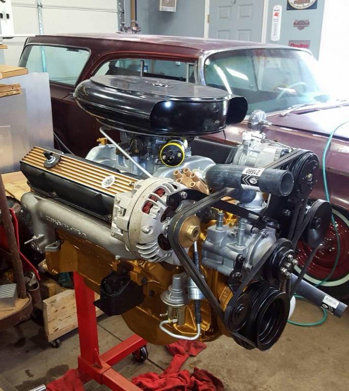

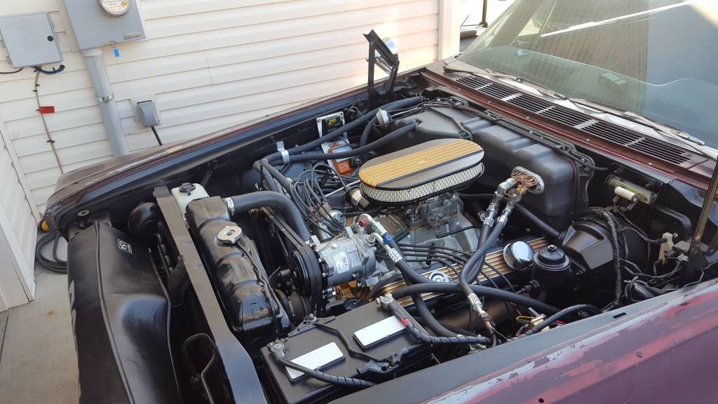

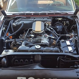

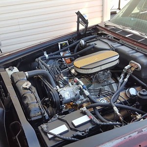

The 63 started out with unoriginal MACCO paint, a transplanted 383 rusty floors but a good highly optioned California Black Plate car. I'm 90% of the way through the mechanical restoration having installed a 440 motorhome engine I rebuilt with Hughes whiplash cam. Updated the Front and rear ac to r134. Everything mechanically works except the vacuum power door locks which is going to be a pain considering there's no kits to rebuild them as far as I can find. I had to disassemble all the power window motors and cobble together 6 units to get 4 to work. BTW, all 4power window transmissions are unique. Refurbished the instrument panel replacing the ammeter with a v. Meter. Also updated to a transistorized 5V voltage regulator for the gauges, they work perfectly. Refurbished the power seat motors, Had to completely refurbished the ratty wiring harness and upgraded to a modern 12 circuit fuse box, upgraded to 78A alternator, Mopar electronic ignition. While the motor was out I completely refurbished the HVAC system, replaced a few servos, bought a crimper and fabricated new custom ac lines.
I still have a few big upgrades I want to perform, I have a 46RH Overdrive Transmission from a late model Ram I plan on putting behind the BB with a JH bell housing adapter, along with a 3:91 sure trac, and I almost have all the parts for a disc brake conversion using all Mopar hardware.

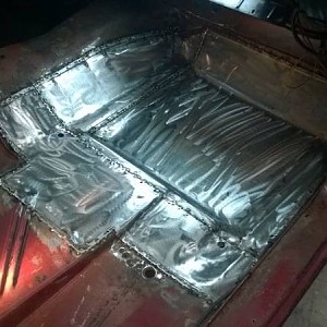

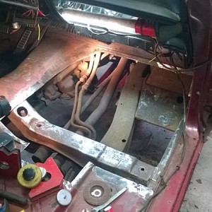

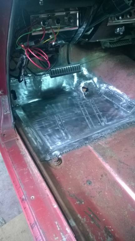

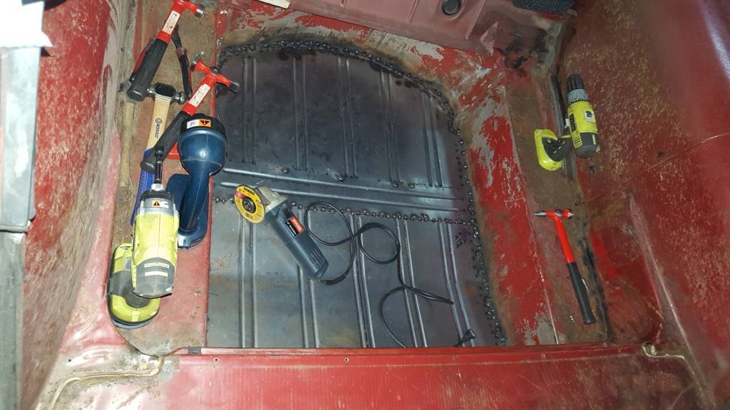

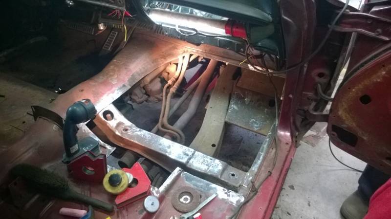

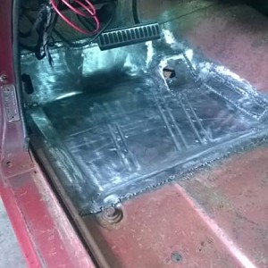

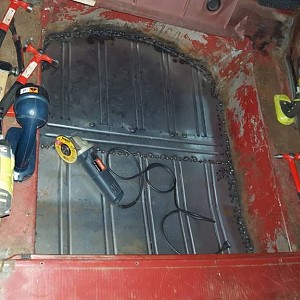

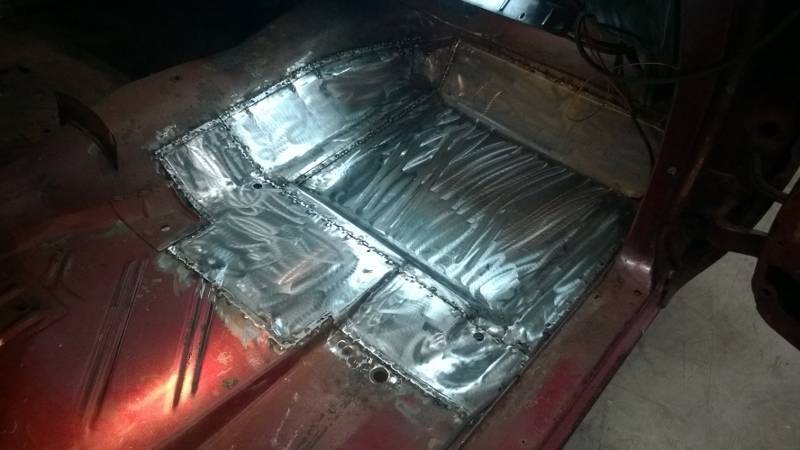

My plan all along was to get it mechanically 100% before I tackled the body. I did however have to address the rotted floors in the front and third seat footwell in order to have a sound derivable vehicle.

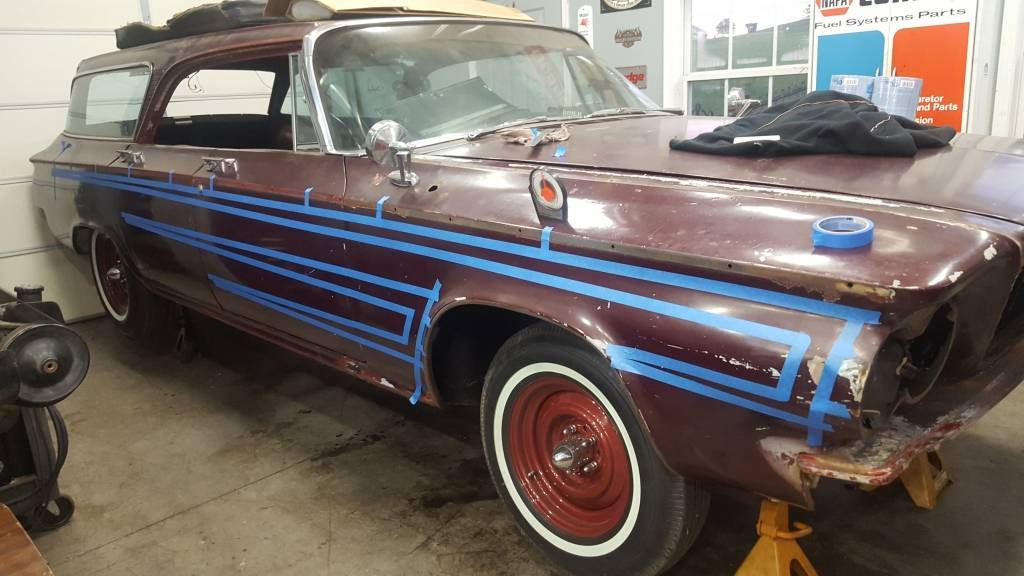

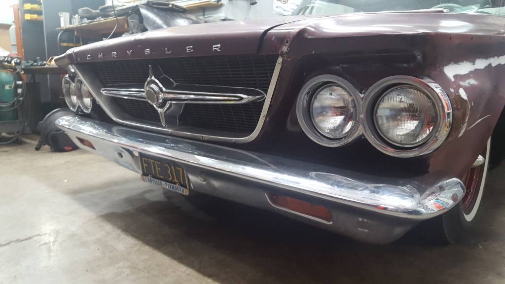

I'm quickly getting to the point where I need to decide on paint. I love the matt black look, but I think its a little too trendy and will likely fade from popularity in the near future. Or I could go with the cranberry-ish factory color with or without a Pearle white top. The red and white paint will be more expensive but I think it's timeless and wont ever hurt he value of the car.
Thats where I am, let me hear some opinions.

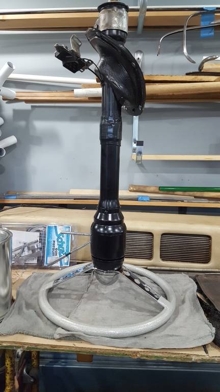

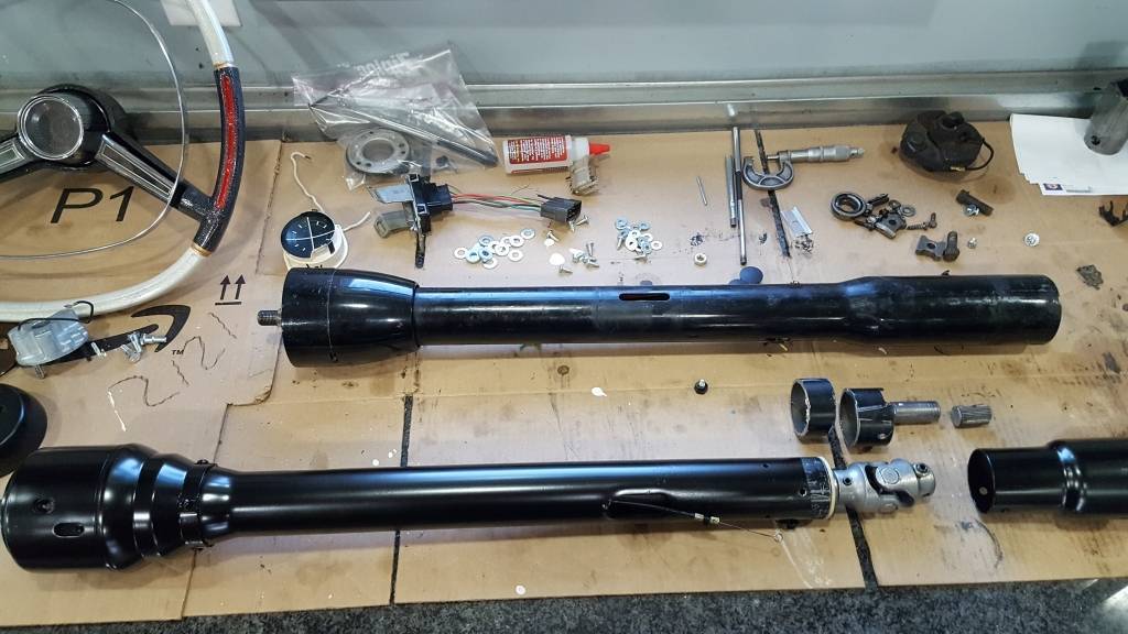

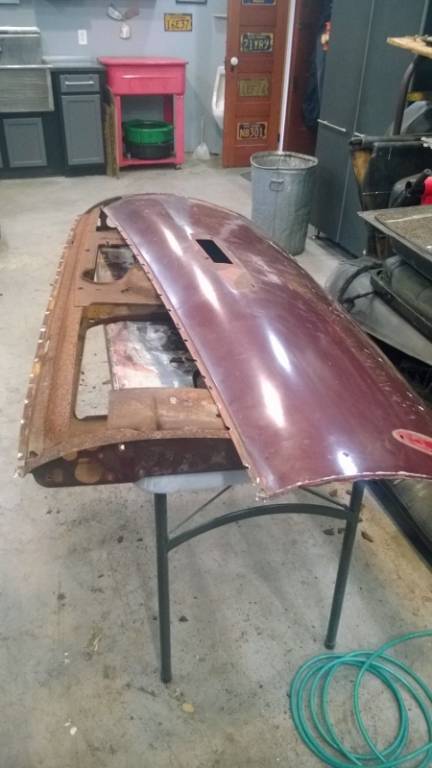

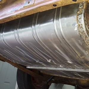

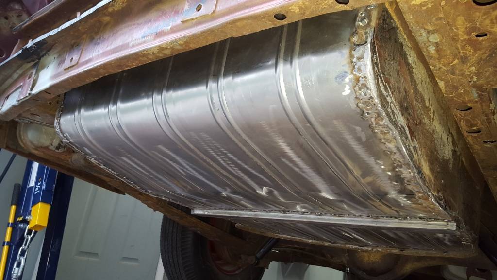

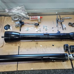

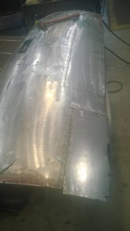

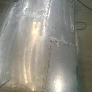

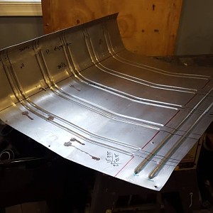

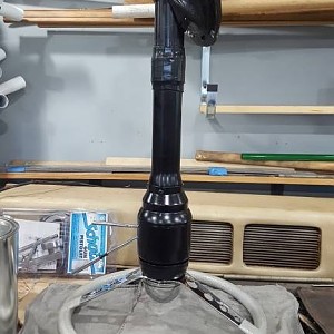

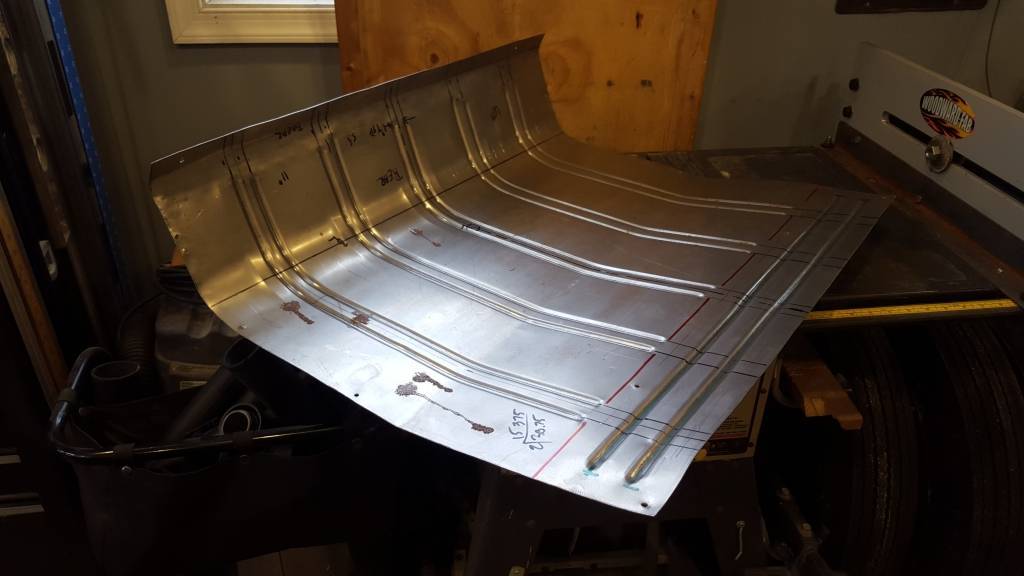

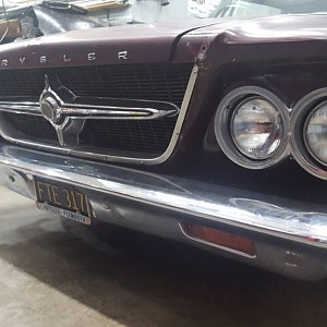

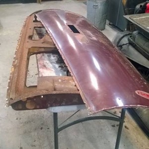

Added a few more pics, I forgot to mention the 64 Imperial tilt steering column, I thought it would be a bolt in.... R-ight.. Along with the tailgate I had to tear down to repair the torsion bar mount that counter balances the door along with more rust repair and I shaved the old emblem off.. Some other pics show modifying the rust repair panels for the front floors since they only covered about 80% of the area needing repair. Additionally I rebuilt the front end thats why the camber is off in one of the pics.....
Wow, you're doing a great job here. Colour wise, i would go for the "Original" paint. As you said, flat black looks great, but could be a "fashoin" colour in the future.

Cranberrysh colour must be beautiful, with the pearl top!
Great job in the engine room!
