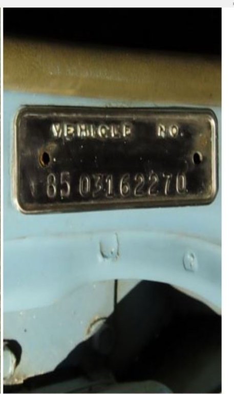

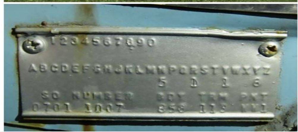

Hey guys
Is there anyway to know the month of manufacture from the tags /chassis no.?
Thanks.

Bottom left of your fender tag it says SQ which stands for Sequence, which I believe means month and day for scheduled assembly, based on when the order came in - and is not necessarily the actual date of assembly. There is some debate about that, but it stands to reason that it's the actual scheduled build date, which could result in the car being built a few days after that.
This my understanding as to how to read tags for assembly for 1966 cars. I don't know if it applies to 1960 or 1961, so I could be wrong.
If I read the code properly, it says July 1. A late build for whichever year we're discussing here. Assembly would have stopped soon after so they could prepare the assembly lines for the subsequent year's cars.
Since assembly of a particular model year started in the later months of the year prior, anything built October/November/December of the model year would have A B or C as the month. So if a 61 was scheduled for assembly on November 23rd, 1960 it would read B 23.
Again, I could be wrong.

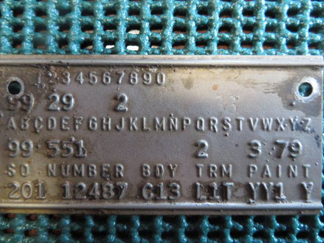

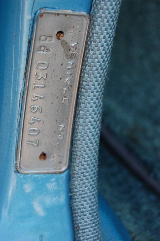

VIN tag say this is the 62,270th car scheduled for assembly at Chrysler's Jefferson Ave. Detroit plant--a 1960 model year Chrysler Newport Town & Country station wagon. The Body Data Plate indicates the car was a two-row Newport wagon scheduled to be assembled approximately on July 1, 1960. It was vehicle #7 scheduled to be built on that date on assembly line 1. Its roof and lower body were to be painted Alaskan White. The numbers under the letters in the middle of the plate tell about certain options on the car. Pretty sure the 5 under the N sands for the heater. Other codes, I have not yet researched. Thanks for posting. Attached are similar plates from a 1960 300F convertible.

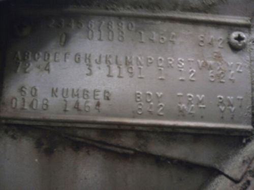

Hi, Ross: I want to encourage your interest in the data on VIN tags and Body Data Plates. My research leads me to believe the lower LH letters stand for Schedule Order-part of the scheduling system and in date format--thus, 0701 means a scheduled assembly date of July 1. The VIN tag tells us this is a 1960 model year car and this leads us to infer the full scheduled assembly date was July 1,1960. In 1965, MoPar Body Data Plates needed a few more characters on the bottom line so assigned letters A, B & C to the two-digit months of Oct, Nov & Dec. Thus, a 1965 Model year car scheduled for assembly on Christmas Day, 1964 would have the characters C25 under the SO letters. Previously, 4-digit date codes prevailed. Note: Previous three-character codes under "PNT" for paint codes expanded to up to five characters under the letters "PAINT". additionally, beginning in the 1965 model year, information on other options began to be shown under the numbers on the top line. Previously, this data was often just a partial repeat of the data on the bottom line. Keep studying, observing and gathering data-in the hopes of discovering the science of the plates.
