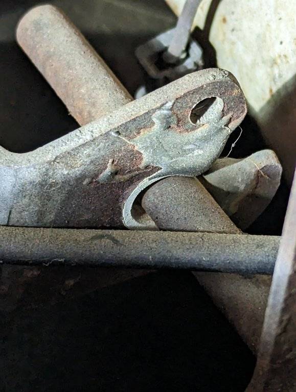

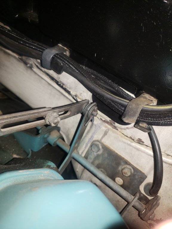

Just a guess is the accelerator pedal shaft pivot loose. Originally there is just a plastic bushing, I replaced mine with a bearing.
View attachment 620254View attachment 620255
The pivot is pretty tight and so is the arm mechanism... However you can completely move the whole entire arm with ease... Thinking the spring is wore out.. However it could have been setup purposely like this as the previous owner could have preferred a light feeling gas pedal.. I also have a mercury comet.. Yeah I know not a mopar, however just for example on that one someone added an extra spring from the carb to the front of the engine just above the manifold and that pedal feels a little hard to push.. Almost like it gives your foot a workout to hold a speed..

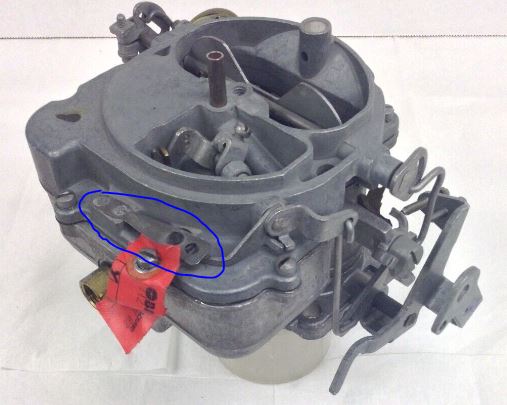

Just a follow up I am trying something else and will report back.. I read in another article that the accelerator pump could need adjustment to get a little more volume when it sprays.. Yesterday I used a wrench and put a little kink in the accelerator pump rod just didn't get a chance to drive around because it got late after my sons football game. The little flapper deal that sits in front that opens and closes when you accelerate.. Pic below circled... Guessing "air horn" if I got my terms right popped off its little tabs.. So I had to JB weld it back on the carb to get it to stay.. Sucks but things just don't last anymore... However I did notice the little rubber at the end was upside down as the flat side was on the whole not the actual rubber piece that should go in the hole.. Sorry for terms I am not a carb expert..
