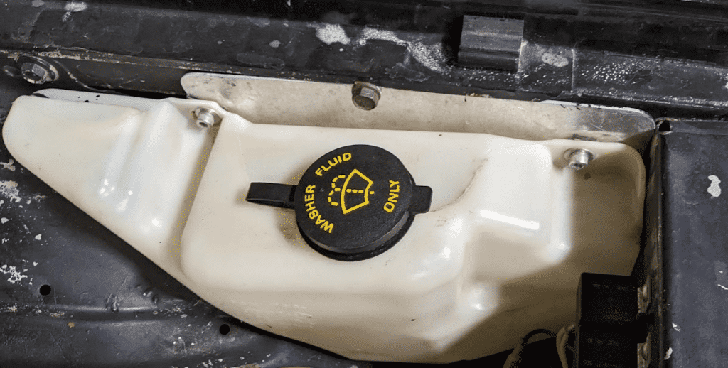

Here's one I put in a 65 300 some years ago.
Is from a mid/late 90s Crown Vic and it fit pretty easily with a simple aluminum hanger plate.
Won't fit all Slabs as some have a starter relay mounted where the 'point' of the bottle is. (my 68 Fury has a relay there)
I thought about CNC'ing some nicer mounting plates for a reasonable price - but after a guy buys that plate from me, pays shipping, buys a Vic bottle - he'd likely be into it for $50-75 total and I figured everybody would want the correct bottle in there... :stop:
Now that's a creative solution, on the cheap! Bet there's tons of good Crown Vic bottles available for next to nothing . . .

Ford part number F4AU-17618.
1992 - 2011 Grand Marquis, Crown Victoria
Dorman has a reproduction version, 603-167
Yeah, I got the bottle for free from a buddy. U-Pick yards probably have those bottles for $5-10.

Excellent work, @MoPar~Man! I see you joined just a few months ago, and that is a very informative contribution - that's how we like it, keep up the good work!

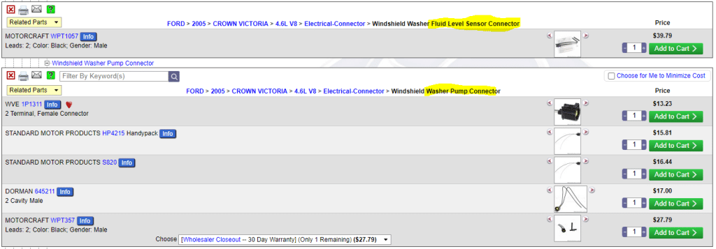

New bottle is $19.61 from Rock Auto. Includes pump, cap, everything but a wiring pigtail. Prices on wiring parts almost make it prudent to get the whole thing from a JY.
