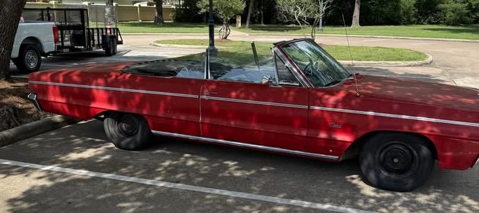

1966 Dodge Polara Convertible Houston TX $10.5k

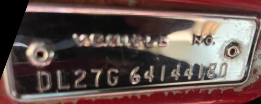

VIN is DL27G6414180, VIN plate does not say "Made in Canada"
I thought these verts were made exclusively in Windsor? VIN says made at Belvedere.

In 1966 (and 67) the VIN is in the door jamb, as seen in the photo above. Plant is Belvedere (7'th digit in the VIN).

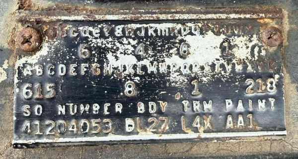

For what it's worth:
d6 j4 p6 u1
A6 B1 C5 K8 R1 X2 Y1 Z8
SO Number 41204053
BDY DL27
TRM L4X
Paint AA1
Engine code 61 = 383 2bbl
auto trans
Z8 combined with AA1 = "buffed" silver ?

Z/8 and AA1 does indicate Silver and buffed paint so either there's been a repaint or the tags have been moved to a new body.
SPD and VIN match well. For MY 1966, Belvidere plant seems to have been a slow roll out.
