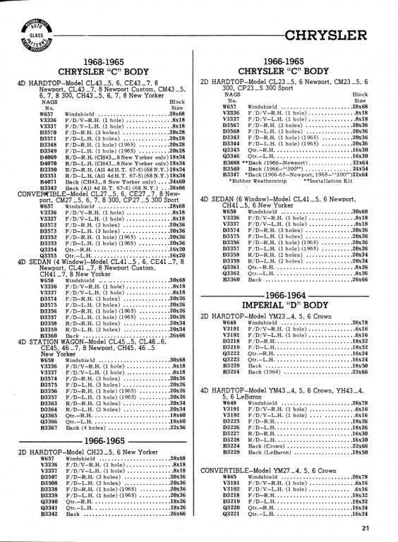

If I read the Factory parts book correctly the 2dr and 4dr sedans along with the wagon use the same windshield across the Chrysler/Plymouth/Dodge c-body line for 1966.
The hardtop and convertibles are different.
Alan

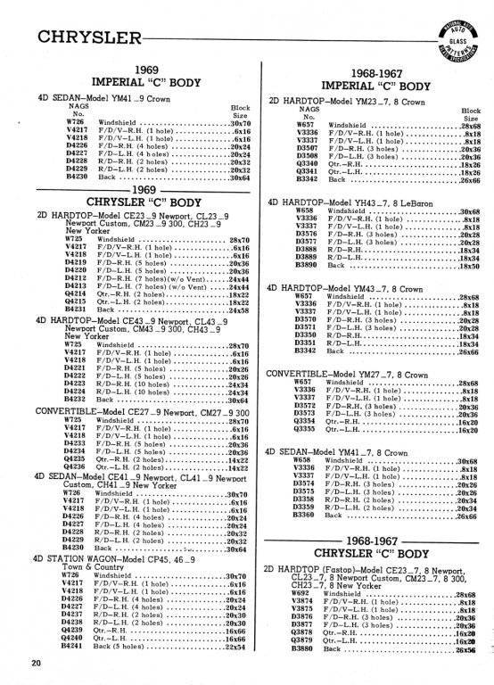

It also appears that 66-68 are the same (sedan to sedan), 65 and 69 appear to be different.
Alan
Here's what I have. It shows the NAGS pattern numbers
With the exact same roof, hood, fenders, dash, between the 2 dr and 4 dr sedans I can't imagine 1966 sedans not being the same windshield.

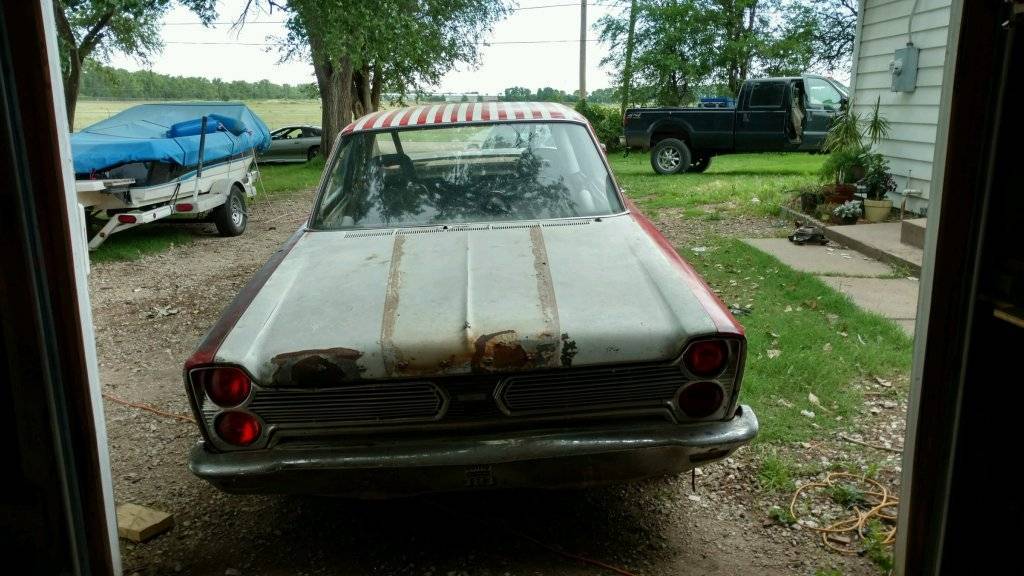

btw can we see a picture of your Fury?

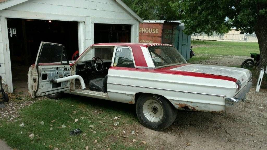

Jakenks, hello and good luck. I, too, have a '66 Fury I, which you can see to your left. Thanks, 300rag for jumpin' in there with the info.
Btw, what is the dealers name and city on the trunk of your car? My car, fortunately, came with a dealer vanity trim plate for the rear license plate. It came from Lees Chrysler-Plymouth in San Gabriel, Ca. It's green and chrome.
