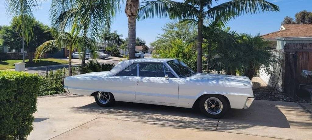

Did the 1966 Dodge Monaco come with a Single drive shaft ?

I have an issue with pinion angle and the driveline shop tells me it originally came with a double shaft. Just didn't sound right.
'66 Imperials had a 2 piece shaft so that may be where they are getting that from.

The car does sit pretty low.
