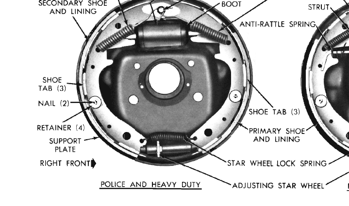

Did you put manual adjusters with the proper spring in to replace the self-adjusters?
Looks like this:

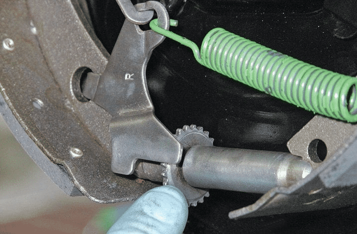

I don't find it hard to install all the hardware. Why do you say they don't work? Did you take the adjusters apart and clean them, grease the threads? I have seen the wire with the hook that has come in the wrong length (or at least I have a pair of new ones that are too short for some reason).
Looks like this:
LOL, ah, No, just deleted the cable, I didn't realize there was a difference, so, the star wheel is different? would i just order adj & spring for 68 r/t ? what difference does it make for educational purpose?
ah, not that I can't, it was just so much easier than fighting with the wire quide always falling out, if I have to, I can reinstall, thanks

The cable pulls the adjuster lever so it keeps the adjuster wheel from spinning freely. With the manual adjusters, the spring not only pulls the shoes together, but it also keeps the adjuster wheel from spinning. So, you cant leave the lever and cable out.... The adjuster will just spin freely and the drum will either lock up or end up too far away from the drum. I think it's kind of dangerous to leave it like that.
The manual adjuster star wheel is different, being a much coarser "star".
That manual stuff is much harder to find and new self adjuster hardware is easy to find and cheap.
IMHO, the adjuster isn't that hard to install either. I'd do that.
Manual adjusters were also on police and HD Trailer Package cars. I concur with using the GTX/RT orientations, though, as they had 11" brakes on them, too.
