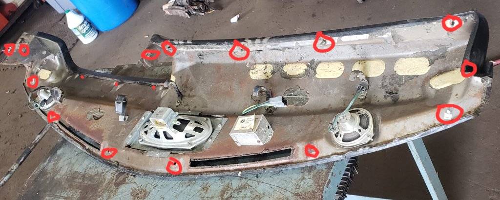

Just started removing plastic covers and things last night. Dash pad needs to be removed…someone did it before did a terrible job fixing dash pad and unfortunately wound up breaking lots of the plastic dash pieces around speedo and under steering wheel. I’m going to try and straighten all this out. It’s a factory A/C car. Looks like I now have to remove inner glove box to get up in there to remove dash pad nuts on passenger side. I have inner cigarette tray out. I can feel some dash pad nuts up in there. I think what’s left is around speedometer area now. Believe I have to drop that down…maybe completely take out? To get to nuts on dash pad around driver side area. Sound about right to you guys that have done this before? Maybe there’s a video or procedure on it? Thank you, Bob
Hey there. There is some Phillips screws holding the pad to the dash frame. You should be able to pull the cluster and the black metal surround that goes around it, that will reveal them. There's 3 or 4 if my memory is correct.
Also there's 2-3/8" nuts inside the drivers side vent.
I ALWAYS pull the entire dash assembly. Its a Pain to do otherwise, but certainly can be done. I dont have the patience.
Here is something to guide you a little bit.

Thanks for all the help guys. I decided to pull the dash pad only. That photo above really helped. Got it in my basement now. Now to figure out what to do next. Watching YouTube videos. Got to wonder if the grind out/flatten cracks/fill/stretch new vinyl method will be doable. Stretching vinyl/gluing down looks difficult to say the least. And the alternative/painting it…got to wonder if it’ll last. I called justdashes. They want $2900!…plus shipping both ways and about 4 months. The phone fell out of my hand. Last I looked into was over ten years ago and it was $1000-1200 then. And…it looks like they’re the only restoration company out there. Any suggestions out there? Thanks. Bob
