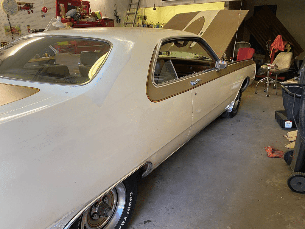

The only oddity I see is the very incorrect passenger mirror, which is understandable that someone may have added it 35 years ago, and notice that the paint color is "close" to the Satin Tan, meaning it was painted at a different time than the car. A cloner wouldn't do that. If this car is a clone, someone went to a LOT of trouble a LONG time ago to do so. With about $45K of work (depending on rust issues or not) this could be a nice car. Wish we had more pics and that fender tag. Anybody want to ask the seller for more info and get back to us?

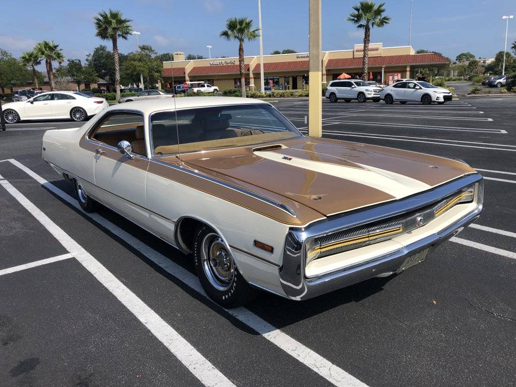

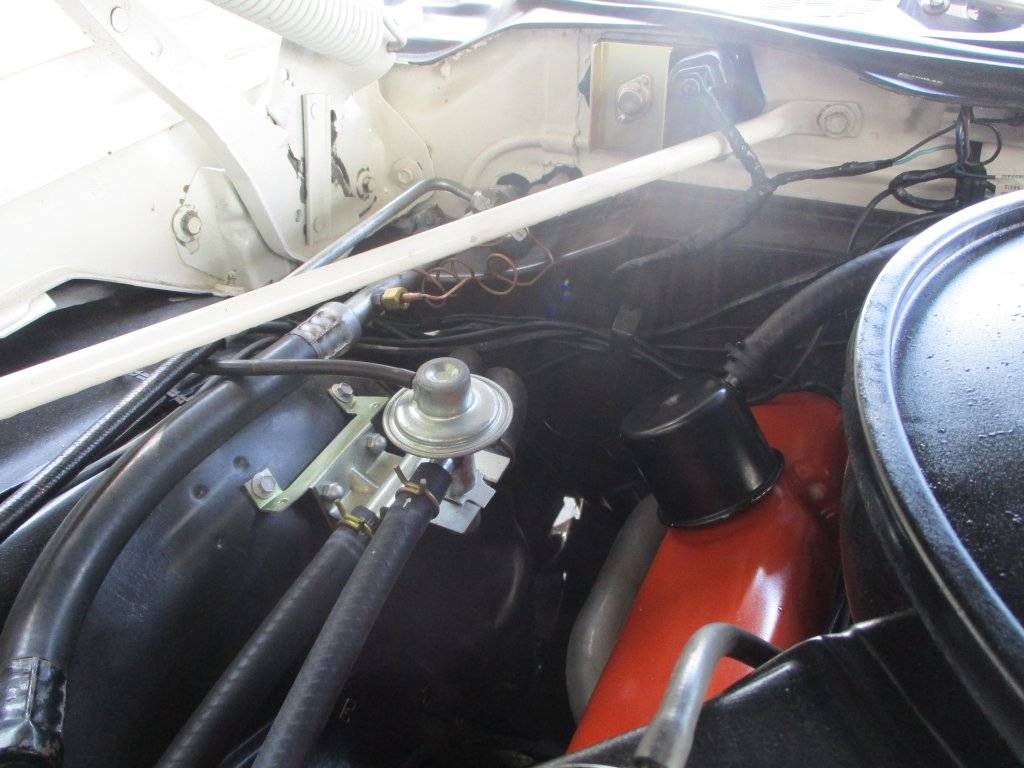

The hood has the same slight "fitment" issues as mine does, such as the passenger rear corner being slightly up and simply can't be adjusted to be even with the fender. As you can see in this pic, my hinge has been fiddled with many times over the years to try and get it right.
Here you can see that hood issue on my car. If I remember to push the corner down after I close the hood, the unevenness is reduced by half....slop in the hinge pivots. I figure that a steel hood is so much heavier that it lowers itself on the pivot slop. Of the ten or so Hursts I've examined, most of them had the same fitment issues. Decklids (which are 100% fiberglass) also had similar warpage for the most part.

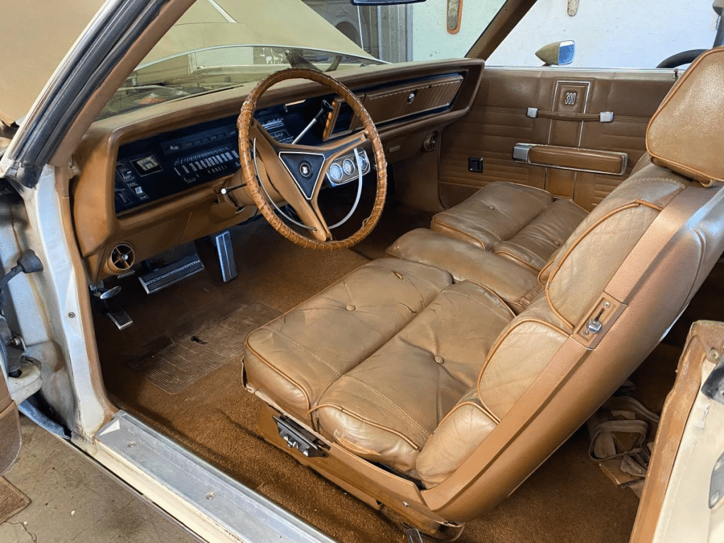

Also--That Imperial interior most certainly marks this as a non-clone....unless someone took it out of some OTHER Imperial a long time ago. Again, not likely.

It has had awful lot of bondo batching up done to it halfway. Both rear quarters (yucks), rear window surrounds, the drivers side front fender... It takes a lot of dollars to fix those up correctly, and consequently should be way below 10K car in that condition.
