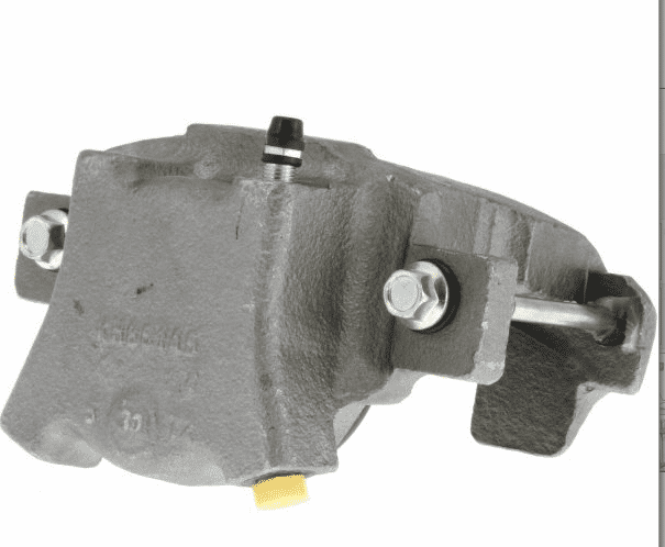

Hello all,
I'm looking for a set of pin type single piston c body brake calipers for my disc brake conversion. I purchased a set of spindles and brackets from a 1970 Fury and have been able to get everything needed other that the calipers. Thanks!

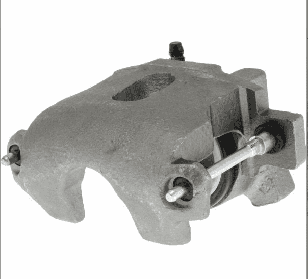

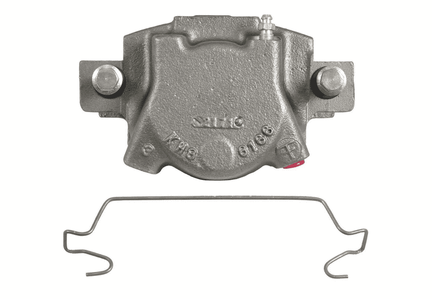

Is this the one you need?
These are for a '70 Dodge Monaco/Polara. Not sure what car you want them for. They are Kelsey Hayes single piston 2.75" pin type calipers for the big 11.75" rotors. Seems KH has at least a couple different casting types of these calipers with different bleed/inlet port locations, but are otherwise the same mounting wise. From your photo, these look to be what you want.
Autozone part numbers C170 & C171
Yep, they come up as the same for '70 Plymouth Fury as well. C170 and C171 at Autozone.
Is there a equivalent P/N for Advanced AutoParts instead of AutoZone? Says that the ones near me don't have local pickup.
I'm not actually sure if there's a difference among the Dodge/Plymouth/Chrysler calipers. I THINK the A and B-Body calipers are actually slightly different than the C-Body ones, but if that makes any real difference I'm not sure myself.
I can confirm that the C-Body rotors and calipers are slightly larger. I have a B body caliper of the same type and it will bolt up but the extra thickness of the rotor does not leave enough room for the break pads. The part numbers for the larger C-Body calipers at AutoZone are C509 and C508 and those are unavailable unfortunately. I'm thinking I will have to find a set to rebuild if I want to have it wrapped up in time for spring.
