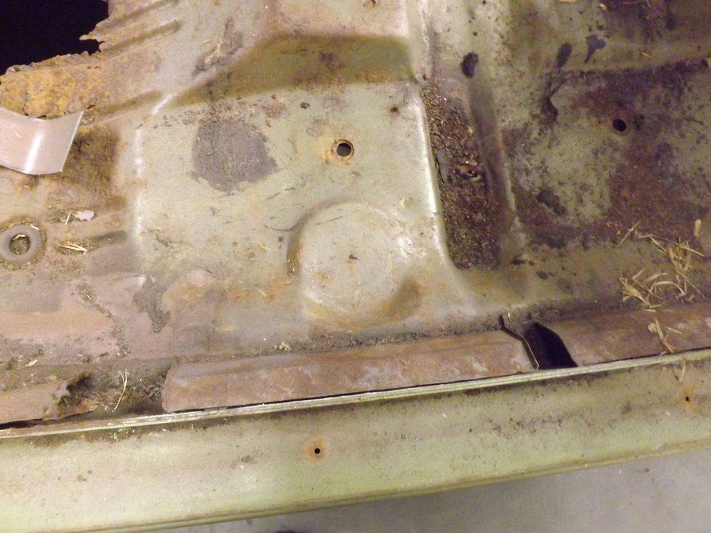

I checked on a 1970 model I have here and while the hole in the floor pan doesn't show other than the round imprint next to the rear mount hole for the seat rail, below it in the chassis the mount is there for the rear mount of the full length chassis with rubber isolators. All that needs to be done is use a hole saw on the floor to expose the mount underneath and you are good to go. No other modifications are necessary.
So with that in mind, all you need do is make sure you have a full set of isolators, the chassis and a radiator support panel to suit that chassis, plus two floor plugs. I have all these pieces and can sell them to you as a package deal for $300.
