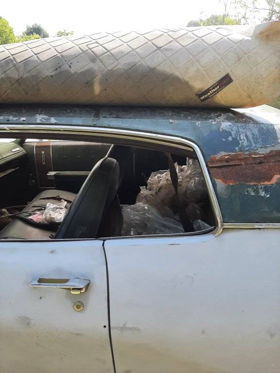

I just bought a 72 fury 3 , unfortunately all the qtr and door glass is broken
What other years interchange ,
And i was wondering if any one in my area would have any 2 door hardtop glass for sale
Im located in n.w. pa

For 23 body: 1972 & 1973 Plymouth Fury and 1972-1973 Dodge Polara/Monaco and 1972-1973 Chrysler Full size 2-door glass interchanges front door glass and rear quarter glass. No other years interchange
Be aware that there were two different 2 door roofs used on the Plymouths and the 1/4 glass is different between the two. The formal coupe is it's own beast and doesn't share rear glass with any other car.

It is the 23 body so at least maybe it will be a little easier to find glass
