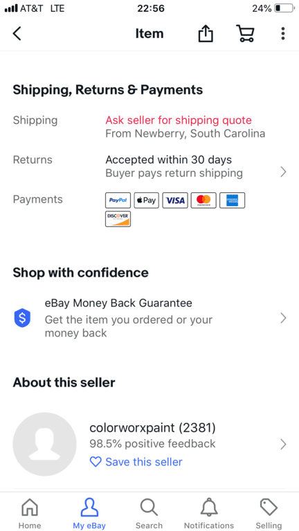

These guys. Do your research though to make sure you’re getting the best deal and produce. No complaints with these guys. I sent them a small interior panel piece for color match. Good luck.
