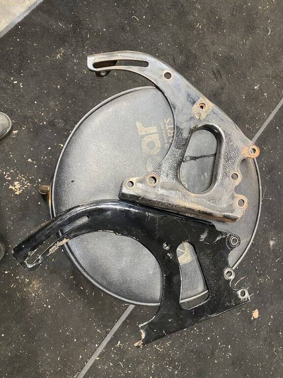

My alternator bracket lower mounting hole basically broke off. Looking for the correct bracket and wondering if there is suppose to be some attaching support bracket. I purchase one for a 440 but the section with the adjustment groove is about 1” shorter and the rear support bracket does no line up with the mounting holes in the head. I have a 1974 Dodge Monaco 440 with a Leece-Neville alternator. Any help or information greatly appreciated.
You could cut and splice/weld a piece from the one that doesn't fit to the broken area.
jim
No stamped numbers on either bracket. Going to look in the Mopar Parts Catalog for a part number.

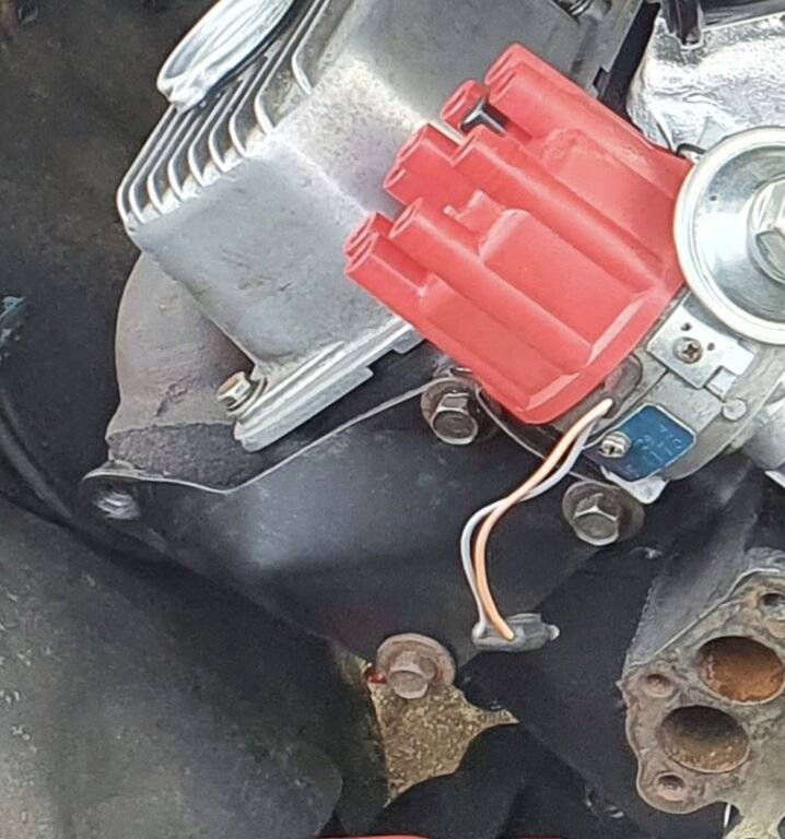

Don't know if this helps but I think the 440 in my '75 imperial has the same brackets. If they are then what you think is the rear support bracket actually mounts on the intake manifold and there should be a third mounting bracket that mounts on the heads, like this:
