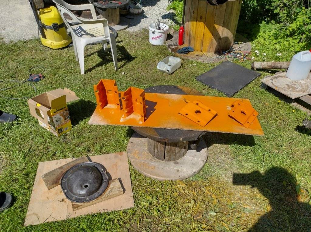

Been fooling around with rust converter to stop the rust evolution - in our latitude we need to guard all the metal parts against mother nature.
Paint has found it's way to of some essentials that need to go back to car with rear axel.

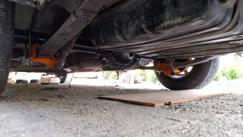

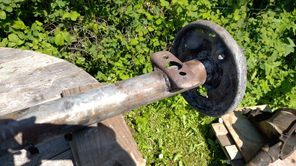

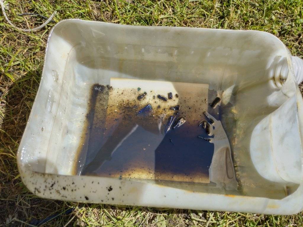

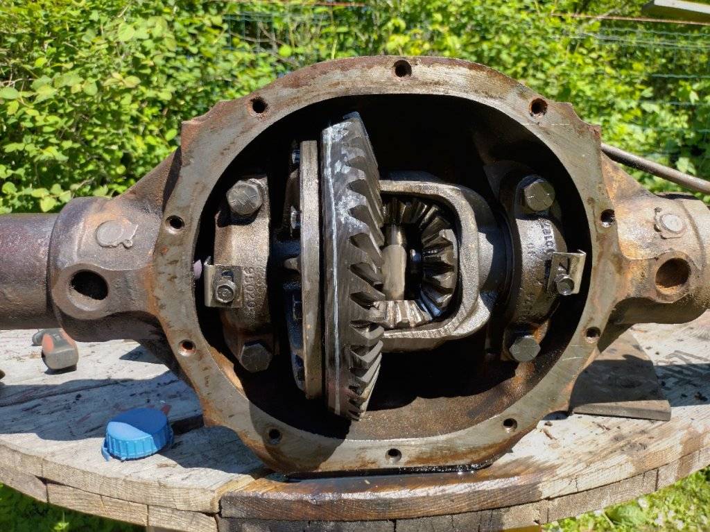

Got the rear axel mounts welded to right place, oil with "additions" trained out from there. All metal parts are ok. Made the teeth test and the wear seems ok.
Murdered some rust and got the paint on there.

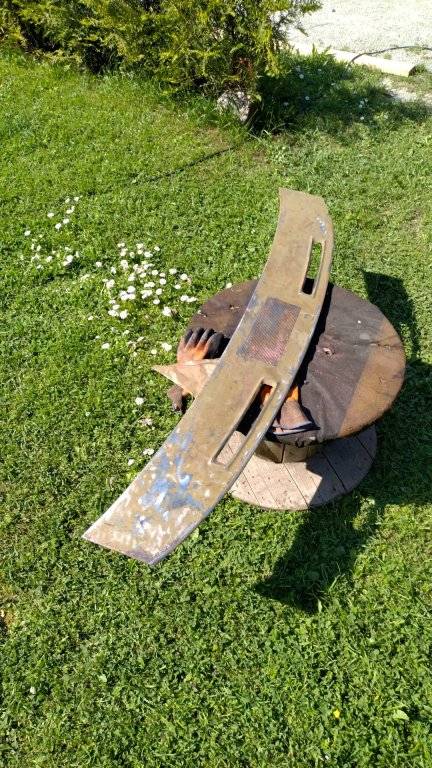

Been going around the wire harness under the dash. Dash lower part needs good rust removal and paint.

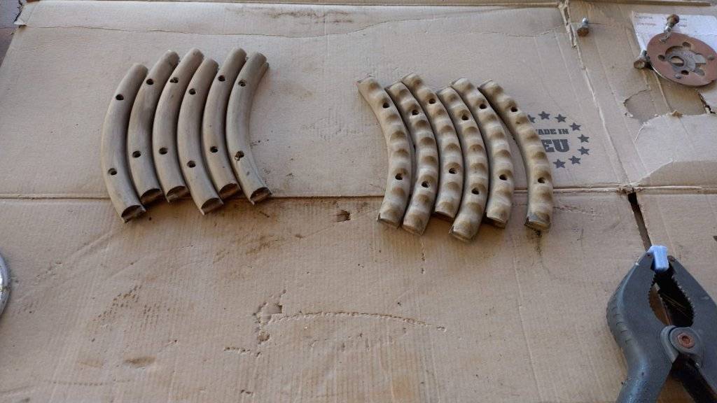

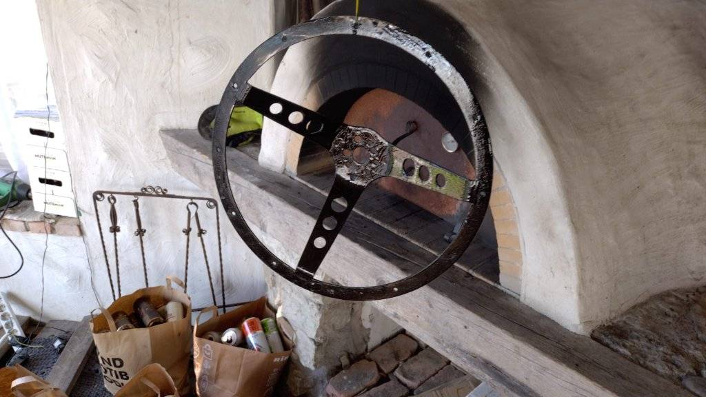

Started to restore the steering wheel wooden parts and metal. During the vacation time decided that we go tan/golden - black with interior.

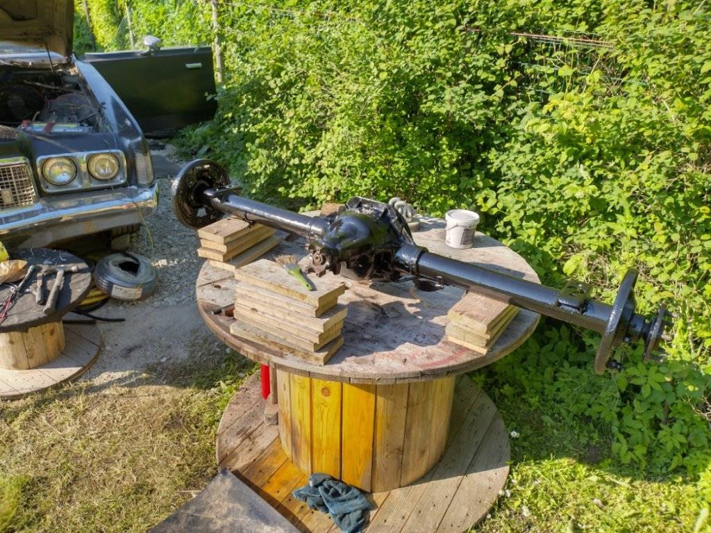

The rear axle found it's way back under the car in rightful position. Rear breaks need's assembly - repair kit arrived.
