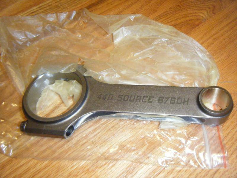

Also when figuring your compression height, note that your 440Source (China) rods are 6.760" in length vs the stock 6.768".
Thank you. I caught that some time ago. Every rod that I looked at was short .008. Why I don't know, but something to take into account on calculating the compression. One place virtually makes all rods, each vendor puts on their own (or not) touch. Scat, Eagle, etc. Yes the heads are very similar. I keep going in circles, add bigger valves, porting, etc and it would not be much more for aluminum heads. Alum heads are probably overkill for my project. Easier hp though?
