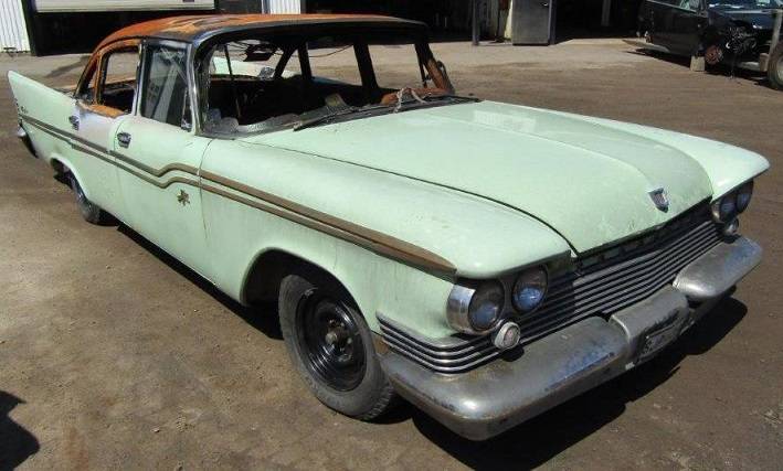

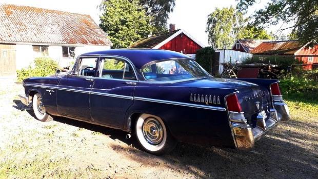

My steering box is way gone, tightend it stone hard but still has a play way to biiig... So I wonder if a box from a -59 Windsor would fit my -56 New Yorker?
I did a little research. I found some matching part numbers that indicate 57-59 are the same "chuck" (as Chrysler calls it), however the part numbers for 55-56 are different. You would need to physically compare the boxes. You could likely get the box from the 56 rebuilt.
I downloaded the steering sections from the 55-58 and 59 parts catalogs.How do the part numbers for the internal parts compare? The cases might not swap but maybe the guts will.

Considering how different the '55-'56 cars were from the '57-'59 cars, I highly suspect that the two steering boxes would not be "a bolt-in" deal. I also suspect that even if you changed the complete steering systems, that it would not work without a lot of fabrication. Might even need to change the steering columns too. Too many differences.
Rebuilding by a quality rebuilder might be the only option as any other used chuck you might find could be worse than what you have.
