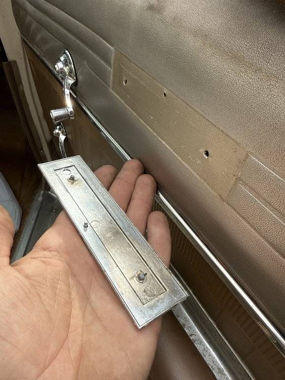

Hey all. I went out to my 66 Fury III to my passenger front door panel “FURY III” emblem on the floor. It looks like the two big mounting studs oxidized off. Is there a clip that holds these to the door panels? Or an adhesive, which it doesn’t look like.
Clean the area with some alcohol and then use some "dots" of E6000 glue. Masking tape to hold it in place, but the E6000 glue sets up pretty fast.
Buy E6000 on Amazon or Hobby Lobby. Get the clear.
I've done this myself and it works well.
Hey all. I went out to my 66 Fury III to my passenger front door panel “FURY III” emblem on the floor. It looks like the two big mounting studs oxidized off. Is there a clip that holds these to the door panels? Or an adhesive, which it doesn’t look like.View attachment 736879
I used Liquid nails and used masking tape to hold it on while they dried, 24, hours! Stayed on for years!
