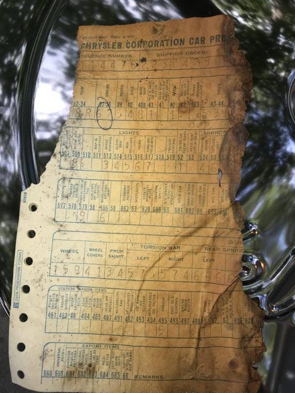

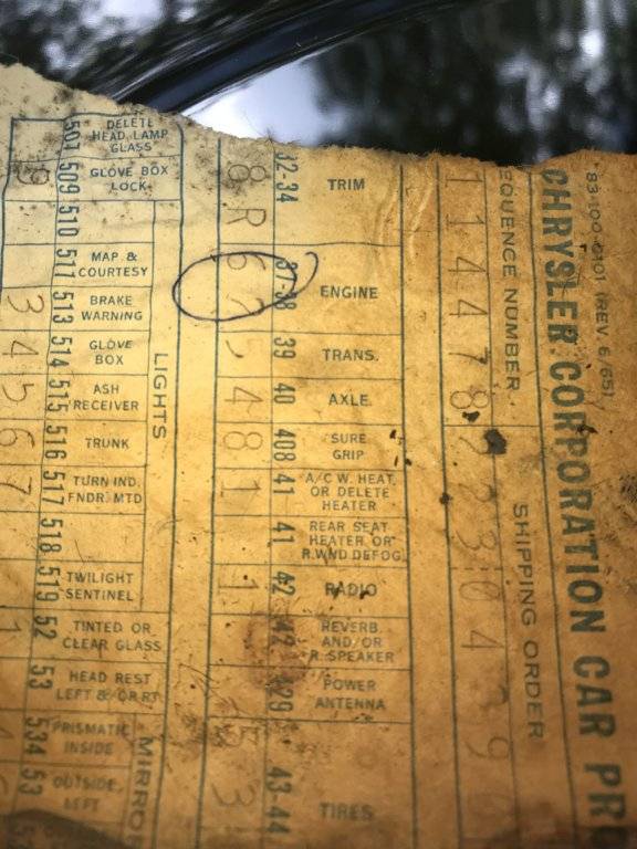

So I found what was left of the build sheet in my parts car under the front seat pass side.
Can someone tell me what the #'s mean under axle and sure grip?
For '66 models
404= 3.23 ratio
408= suregrip
40 is the generic rear end, by adding the 3rd digit, in this case 4, the unit is identified as a 3.23 ratio
The 408 is the code for a sure grip. It is present as indicated by the 8 inserted under the code. If there was no sure grip, the box underneath would remain blank. www.mopardealer.com has a lot of useful information on these cars.
Dave
Thank you sir! Exactly what I wanted to hear!!!
