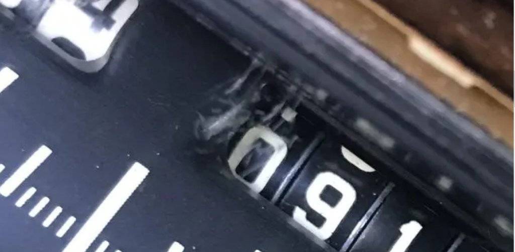

I wonder when the odometer was replaced? It read 87717 when the engine was replaced. Now it reads 09136. That dose not add up with the owner stating its only been driven 500 miles.
Just today someone asked that very 'hardball' question... from comment: :Also take note that the two leftmost numerals of the odometer are askew, a sign of possible tampering. It is surprising that in the twelve to 14 months between the engine work, Oct. 2022, and the photo, the car added 21,000 miles to the odometer."
I noticed some scratches on the plastic speedometer bezel and in the old daze that was a big red flag as to odometer tampering via the 6 O'clock newz, I'd had heard stories of guys that could flip the numbers back with just a old style wire coat hanger, then there were some that would drill a very small hole... I never eye witness any of these tactics and just put it to old guy garage tales... But who knows maybe someone had the idea to spin this one back 'old style'.
