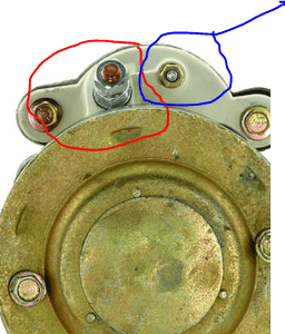

Do you have a test light? You will need a helper, put the test light clip on the battery neg and when it wont start have your helper hold the key over in the crank position and probe the terminal going to the starter and look for a light.
The terminal in the blue
If you have power here, head down to the starter and check for power. Red power from battery, blue is from the starter relay when the key is in the start position.
If you don't have power coming out of the relay and it clicks it is bad
If you have power out of the relay and power at the starter but it wont crank, change the starter.

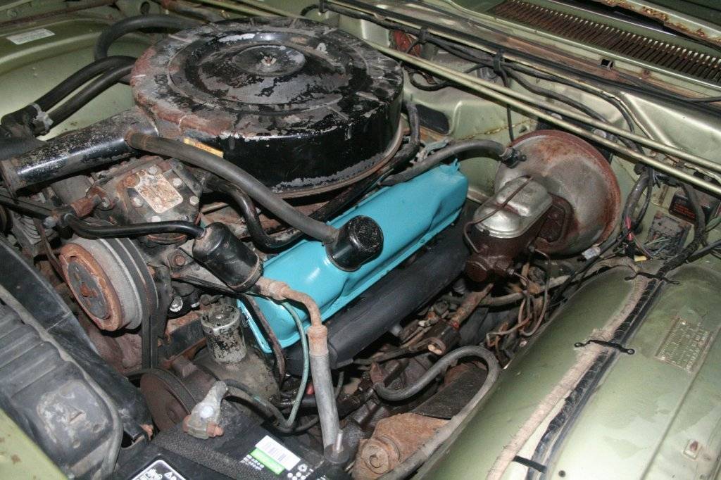

So here's the update. Yes, the starter turns when bridged with a screwdriver. The clicking noise I hear sounds like it is coming from what I think is the voltage regulator, part # 2098300. I can't see where the starter relay is, so I assume it is buried further down. Any further ideas? I am not at all against swapping parts.
It would be normal to get a click out of the regulator when the key is turned on, it should not repeatedly click or buzz. Trace your fusible link back to the firewall, it should be hooked to the starter relay, most of them were mounted close to the driver side hood hinge and close to the firewall electrical plug. Some are also mounted on the fenderwell.
Dave

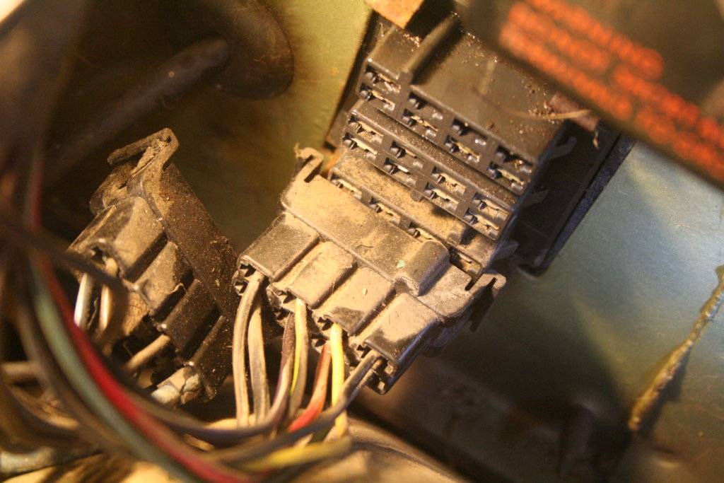

The picture you posted has the voltage regulator in it. There is a picture of my 68. The voltage regulator is on the right side edge half way down . The bulkhead connector is directly below it with all of the wires going through it. A small common screwdriver with about a 4" shaft will help you to unclip the connectors to get it apart. The fusible link that others are telling you to check is a wire with a rubber or plastic tag built into it that goes into the bulkhead connector. See the little yellow rectangle that looks to be sitting on the inner fender.
Here is a picture of the bulkhead connector taken apart. the arrow points to the fusible link. Blue wire with the yellow tag. I would think yours should be the same, but it could be different.
Another shot of the bulkhead connector. Taken apart.
I don't have a picture of the starter relay, but it is mounted on the driver side inner fender just inches from the battery. There is a lead from the positive side of the battery that goes to it.
I hope this helps.
