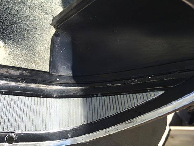

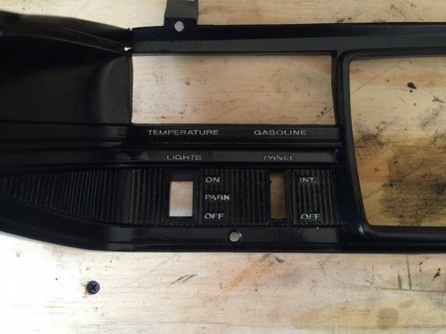

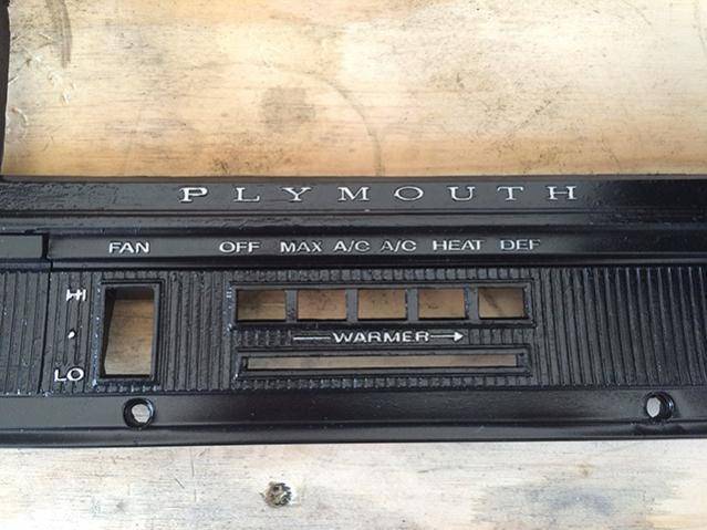

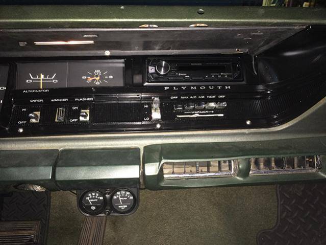

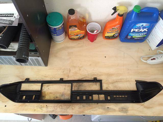

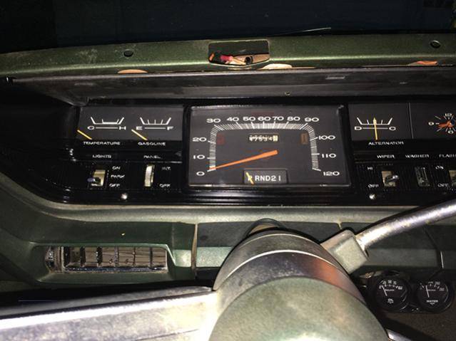

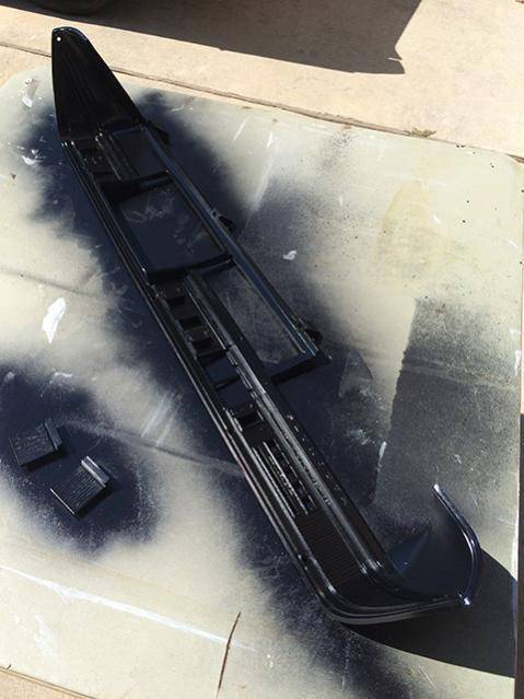

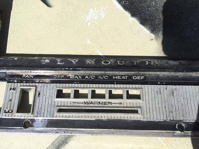

I wanted to share the progress I made this weekend on the cluster bezel on my 68 Fury. I removed the bezel and found that it had been cracked in a few spots. I was able to superglue these spots back together and paint the bezel. I'm very happy with how it turned out and wanted to share a few pics.
Thanks to The Horvaths for the advice on how to paint the rasied lettering on the bezel.
I used the eraser off a pencil to dip in paint and sort of 'stamp' the raised lettering. I had a few goofs, but was able to repaint with black and start over.
