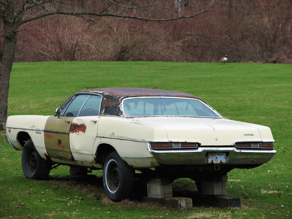

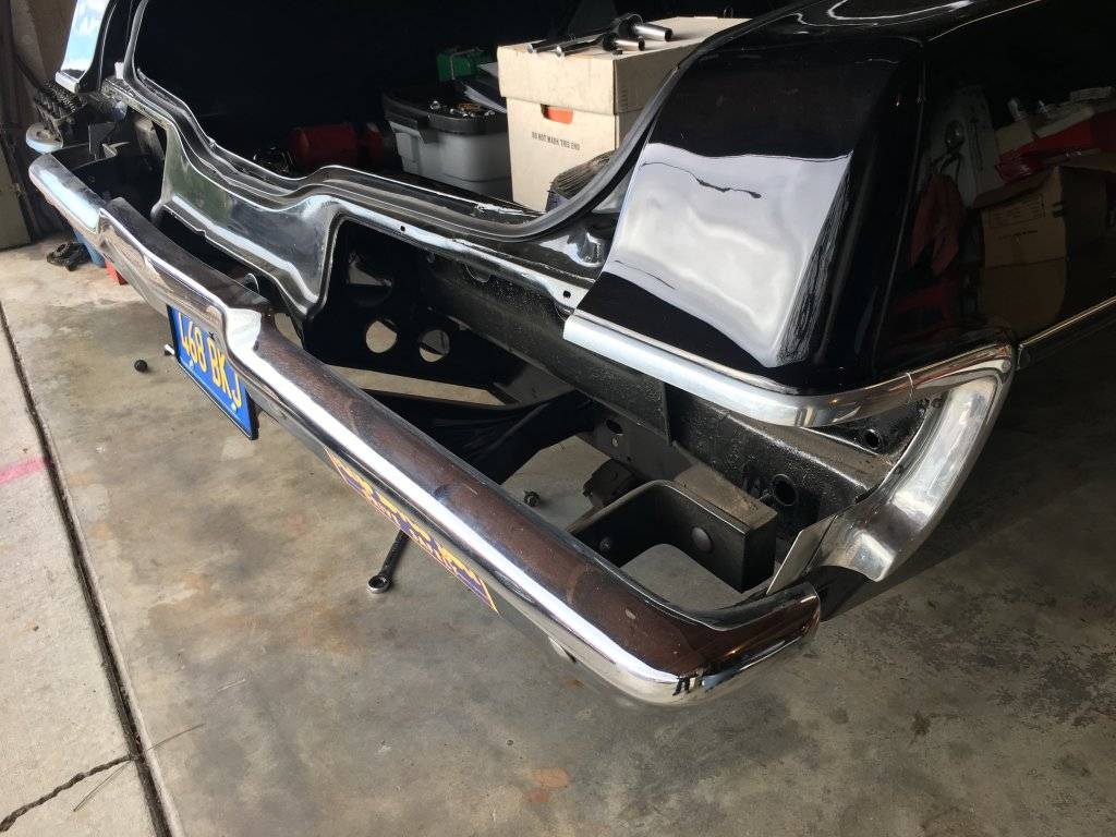

Mine currently has the Monaco lights, they look cool but some day I might want to find correct 69 Polara lights. Plus I'd like to take these ones apart and clean them.
Do the lenses and bezels come out easily, or does the bumper have to come off? Looks like it has a black painted extension running around the edges that's tucked into the rear bumper

Thx, I've done that in the past :)
The thing I want to know that the pics don't show is does the black area on the top and bottom keep it from coming out without removing the bumper? Looks like it's tucked in there pretty good

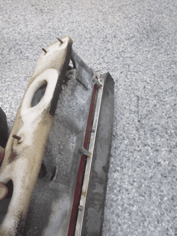

When you get the assy off of the car and the outer lens removed you WILL find "dust" in there. Where did it come from? Look on the bottom part of the lens where it mates to the housing. In that area you will probably find a small "half-circle" that has a white fabric "filter" there. Kind of reminded me of a cigarette filter element, with out the cigarette and trimmed to the necessary length. It can be fragile!
Also, do not damage or remove the thin, white plastic "seals" around the mounting studs! That's what keeps dust out of the luggage compartment. Reuse.
DO carefully wipe things down to reveal the dull silver reflector area. You can refinish that area with bright silver spray paint, or even some of the "chrome" paint available. Also wash the inside of the lens itself.
Might need to be careful of the dried gaskets, too.

Thx for the info, surprisingly complex piece!

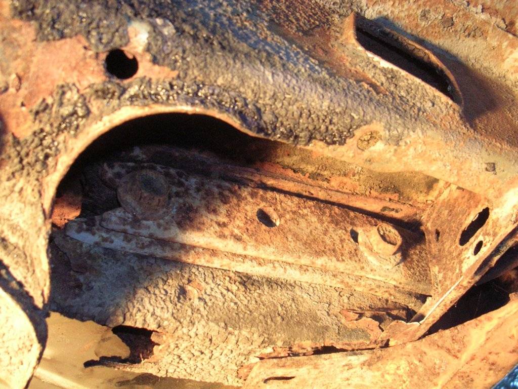

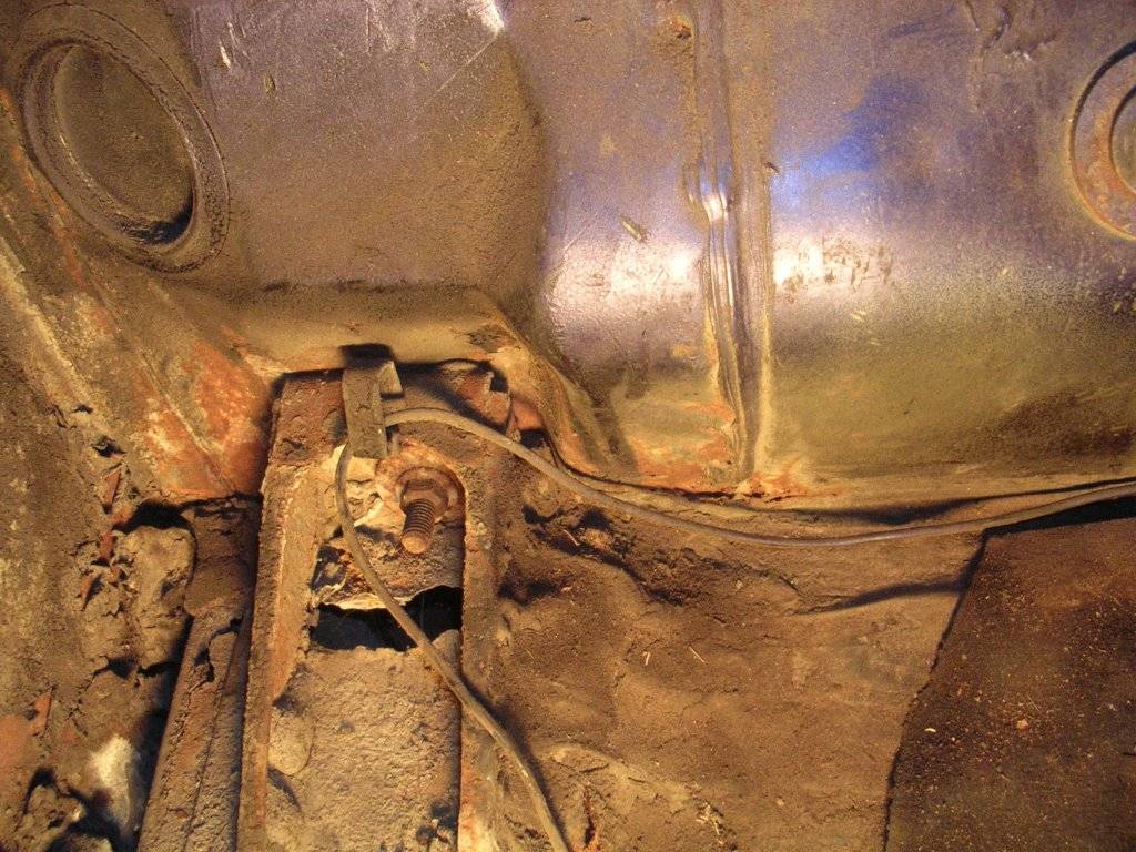

1. I don't think your car has a rear valence or wiring to lights in the bumper, so no action required for either

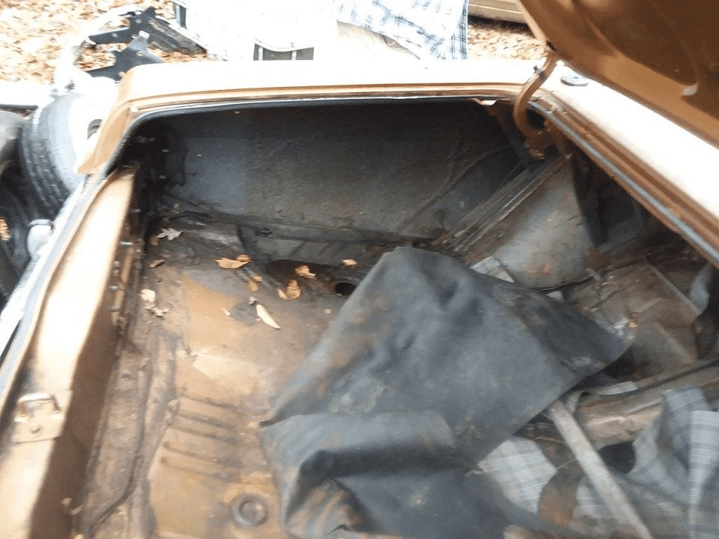

2. In the corners of the trunk compartment, you will find 2 studs that look like this. Loosen the stud nuts the same distance as you want to move the bumper. (pictures from 1970 parts car)

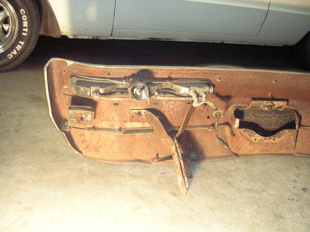

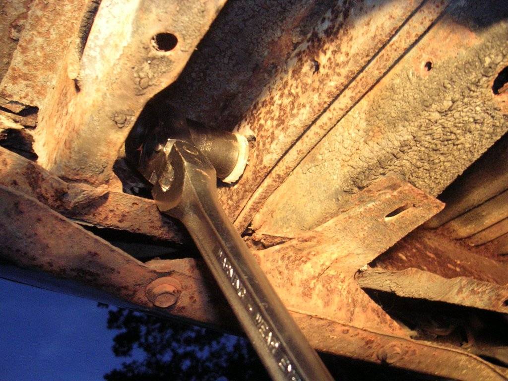

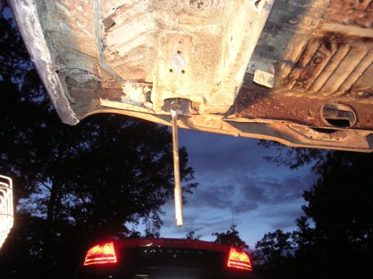

3. At the outside of both sides of the rear subframe, the bumper brackets bolt to the subframe thru adjusting slots in the bumper bracket. You need to loosen the 2 adjusting bolts on each side. After that you should be able to pull the bumper and brackets back by the amount of the adjustment left in the bumper bracket slots, It the bumper won't move inspect for small fasteners that might be holding it in place. Barring that, you may have to hit the bumper brackets with a punch and a big hammer (BFH) to break loose rust.

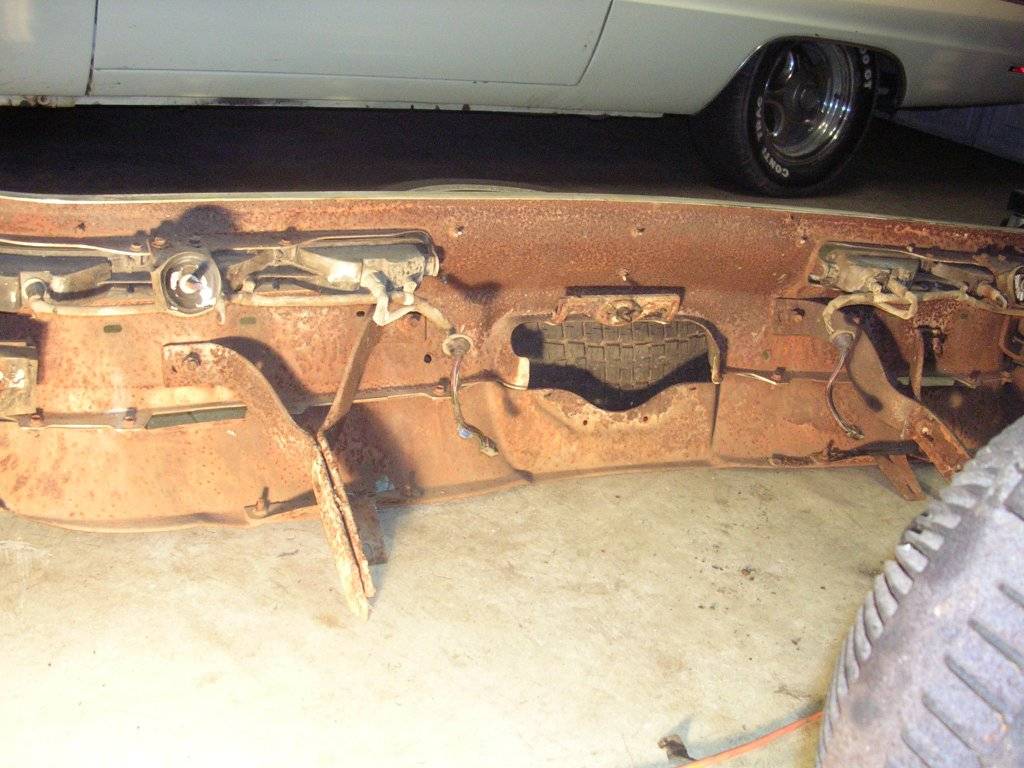

Driver (left side)
Passenger (right side)

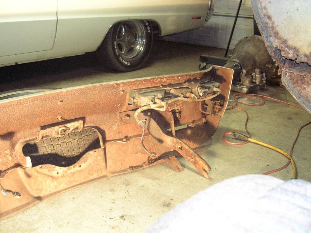

Just to give you an idea, this is a 1970 plymouth rear bumper with brackets
Hope this helps!
