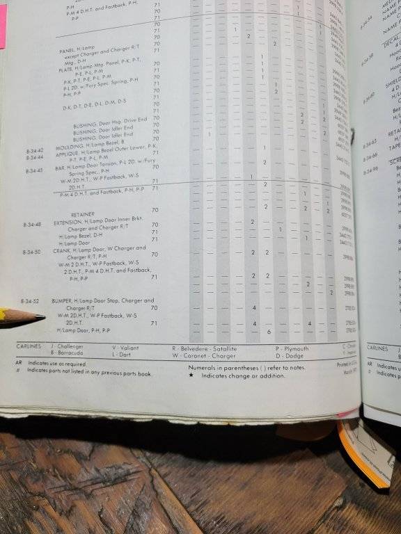

i'm missing a couple of the rubber stops where the headlight doors come down.
any ideas? where to get?
I was lucky to find NOS bumpers on eBay a few years ago. I don't know if anyone reproduces them yet. Have you tried ECS or Detroit Muscle Technologies? Maybe a Charger hidden headlight door bumper would work?
Book shows #2785824 for Charger, Plymouth, and Chrysler. They must be the same. 6 required for a Plymouth.
