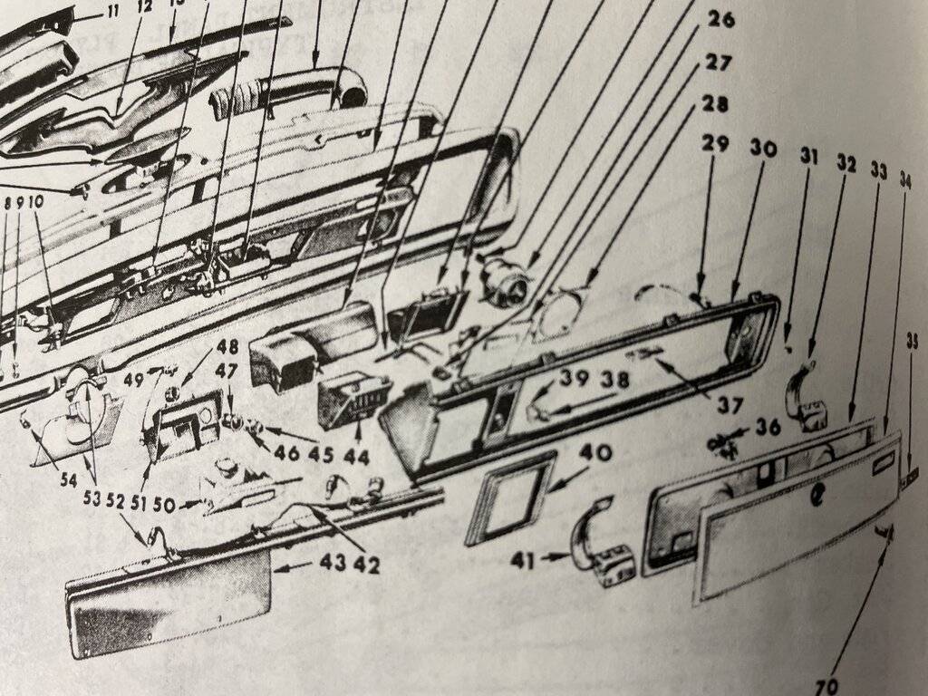

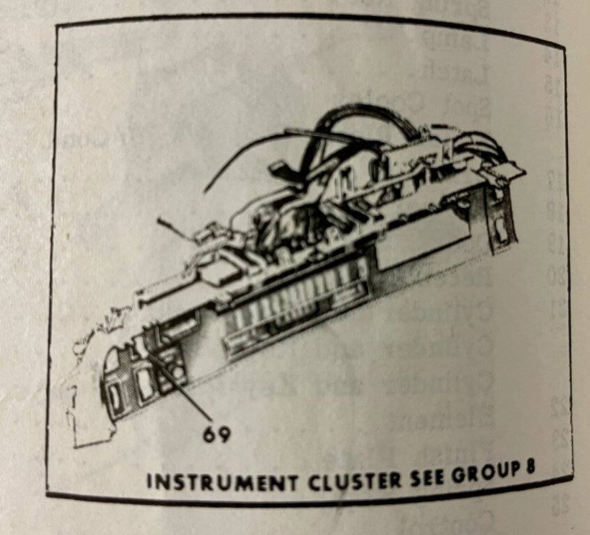

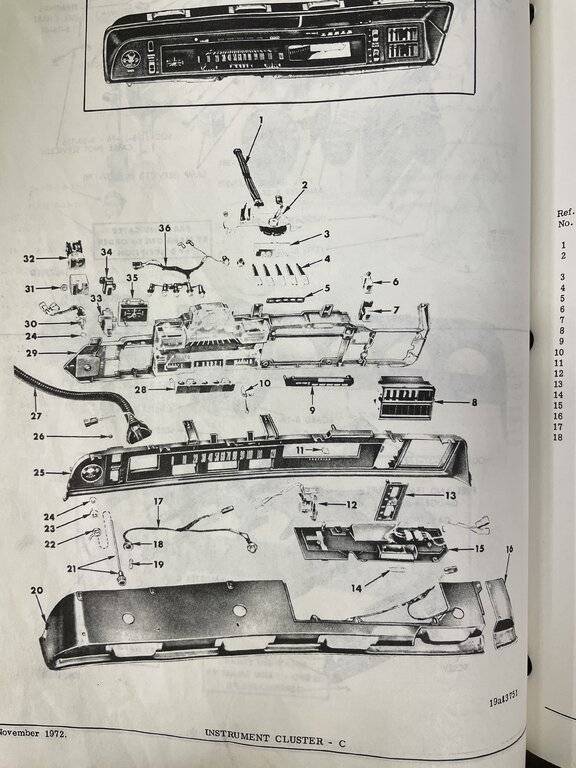

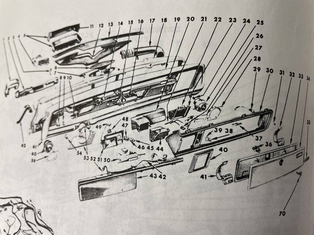

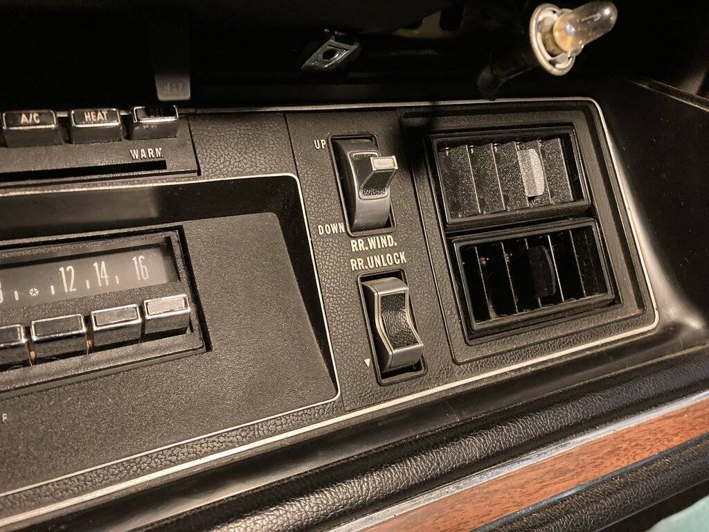

Looking for some help on how to replace the rear window switch on our 72 Chrysler Town & Country Wagon - See pictures. Does the entire dash cluster have to be removed to access the switch?
I was hoping to simply remove the outer housing. However it appears the outer housing is attached from the rear?

Perfect, please let me know. My plan is to replace both the window and lock switches for the tailgate. They appear to be wore-out, the window switch works only half of the time and the lock switch is froze. I have manually jumped the the rear window motor and it works great.

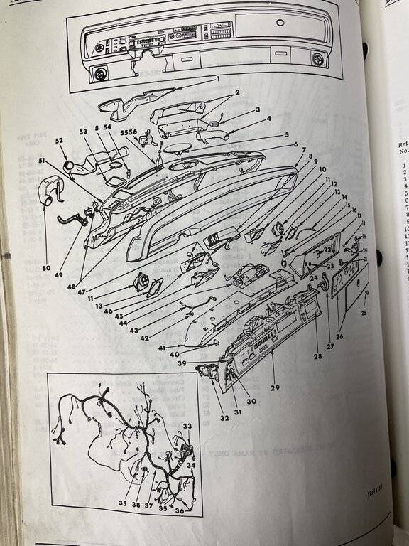

You don't have to remove the entire dash. This is the panel you have to remove:
It's attached with 2 scews, right upper and left lower corner. It's a PITA job but I managed to remove the from underneath the dash ánd true the radio-opening. I used a cheap *** endoscope camera to look what I was doing. Good luck...
