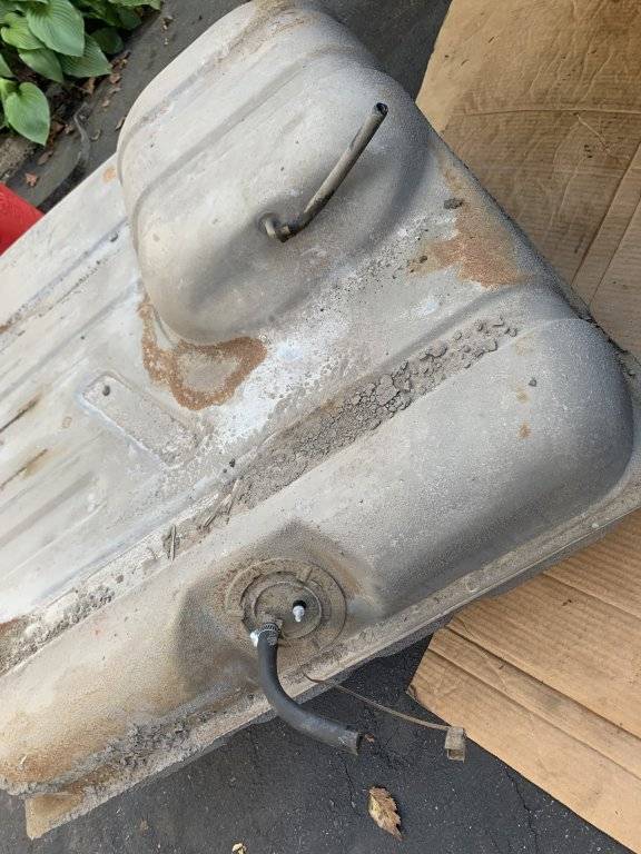

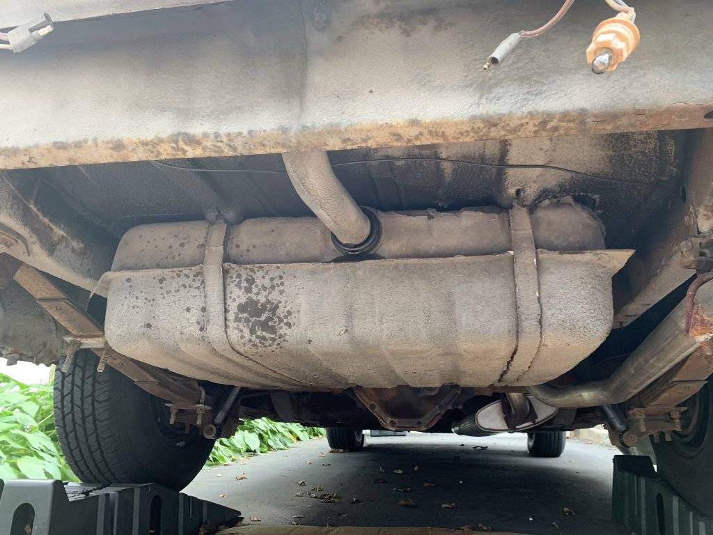

HI Fellas This maybe a dumb question but i need to drain the stale fuel from my tank. Is there a drain plug the reason for asking is there is a rubber plug in the bottom of tank might be a repair. Can yall help Thank you

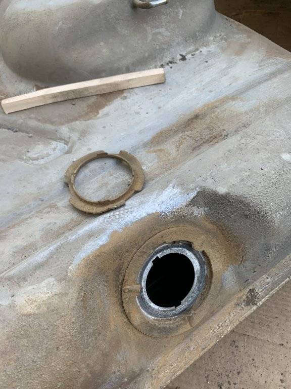

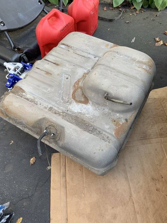

Thats what I thought the nplug i saw must have been a leak repair and if so its still working so i didnt want to mess with it thanks for the confirmatioShouldn't be any drain in your tank. You may want to remove the tank, it's not that hard, and just pour the gas out.
If you do, unplug the gauge first. Just get it out of the way. You may forget, like i did.
Agreed, honestly the hardest part was reinstalling it, helps to have a jack and a friend to keep it aligned.
