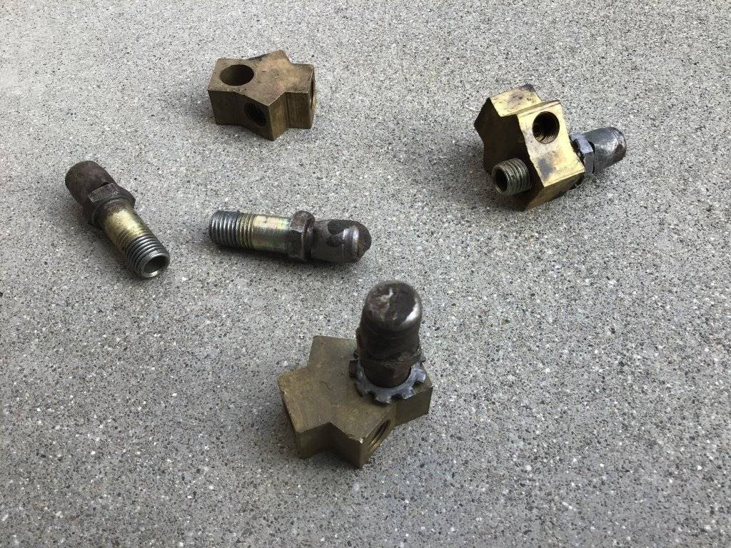

Is this the breather for the diff and how can I get the cap off without destroying it?
thanks

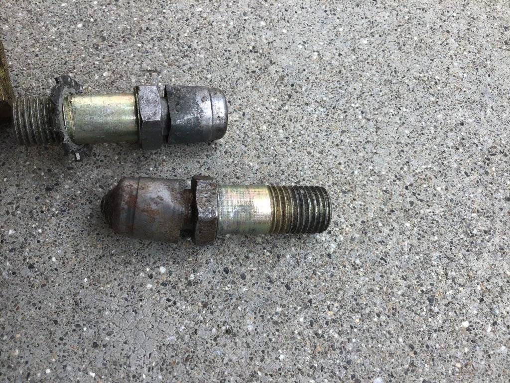

The bolt that holds down the brass block is a breather.
these are from 1967-1968 8 3/4 rear axles. This is what the factory uses. The top of the bolt is a loose cap and it vents the axle.
That is part of rear brakes. It is a essentially a junction box that sends brake fluid to the left and right rear wheels. Do not mess with it. 8 3/4 rears don't have a breather. The rearend assembly is completely sealed so that your gear oil doesn't leak out.
The top is crimped on. If you are careful it looks like it could come off without destroying it.
That particular item might be a brake line junction fitting, but there normally is some sort of breather on the rear axle assy. Not obvious, but usually near the top somewhere, above "the water line" of sorts. Yes, most have a top cap which is loose, but attached to, the base fitting. As mentioned, the base fitting would screw into the housing.

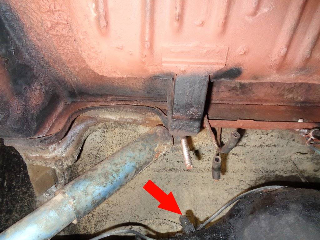

On four wheel drive front axles, a hose attached to a fitting on the axle housing and the "vent" hose is attached to a higher point on the body, so moisture from off-roading might not enter. GM used to use one which is a plastic body, then later ones with a directional top.
Considering the amount of heat the gears generate, there would need to be a way for the air inside the axle to expand and not blow the seals out, if it were not there, I suspect. Similarly, for any condensate to evaporate out due to temperature swings in ambient temperatures, over time.
Those particular pieces ARE from an 8 3/4 axle 1967-1968 vintage. That’s what they have, the vent is on top of the bolt that retains the brass block to the axle housing.
awesome thank you.
I just want to run a wire in there and make sure its clear. Now I know what I'm up against.
I clearly see that it's a vented bolt but is the brass fitting meant to be a splitter for the brake lines?
Yes right and left brake lines and the rubber hose screws into that brass block.
