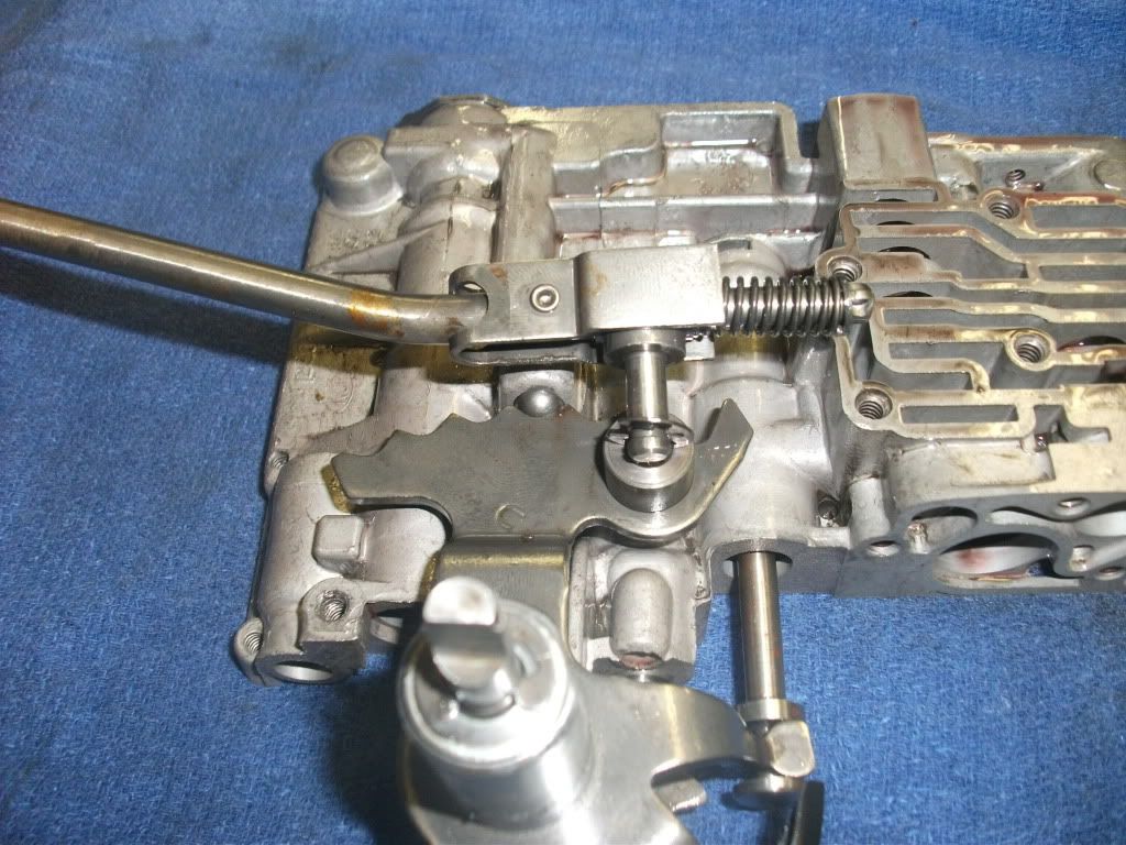

hi all -so im changing the shifter seal and kickdown seal on a 727 transmission... im dorkin around and a bearing and spring come out from somewhere. I THINK it goes into a little hole on top of the valve body, but does the spring go in, then the ball? or the ball, then the spring? 727trans-valvebody.jpg I hope yall can see this pic,, its SPRING and PIN and BALL on the diagram. .. thanks all. - Saylor
i got it, and it sucked. pin is in, spring, then ball. the ball rides in the ratchet teeth of the shift selector thing

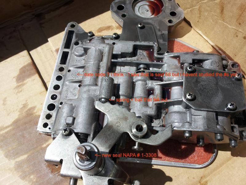

727trans-valvebody-top.jpg the small seal is NAPA # 1-3308 oil seal. its the kickdown lever and seal ... the top lever. OH OH OH see the round part at the top of pic,,, there is a large spring that sits there.. I think the 1-2 spring? Anyways, when you take off the valve body, the spring is pushing down... push up from below while unbolting valve body.. valve body bolts are all the same length, are 7/16, throw them into the pan while you are working, and the big spring too.

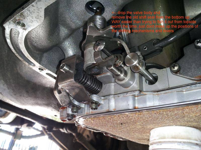

727trans-shift-seal-removal.jpg the shift seal is NAPA # 1-4582. doing this in car,, don't try to fish the seal out from the top side with a pick,, I wasted a day trying this. I finally dropped the valve body and poked it out from the bottom side upwards..easy peasy.

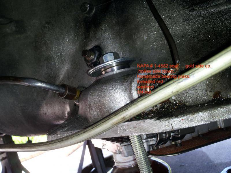

20130428_155421.jpg NAPA # 1-4582 shift seal. going in. my homemade bearing press. not just for BMX bottom brackets :) its threaded rod, 3/4 nuts, and washers top and bottom. pinch together until tight, let loose, readjust, and do it again, until the seal is seated. at the end I used a tapered nose S&K 15/16 socket to get the final countersink on it... you want it flush as possible, it must not be higher than the housing,, it sits IN there
View attachment 11275 NAPA # 1-4582 shift seal. going in. my homemade bearing press. not just for BMX bottom brackets :) its threaded rod, 3/4 nuts, and washers top and bottom. pinch together until tight, let loose, readjust, and do it again, until the seal is seated. at the end I used a tapered nose S&K 15/16 socket to get the final countersink on it... you want it flush as possible, it must not be higher than the housing,, it sits IN there

ok the thing that caused this all was when I took the e clip off of the top of the kickdown seal, that lets everything loose. then I took out the actual kickdown lever. between that and moving the valve body around , that let it slack enough that the ' rooster ' (the shift thing with the ratchet teeth) got out of line with the spring loaded ball, and then the spring behind the ball ejected the ball, and then the spring fell out. To get it back in there was a PITA. I put in the spring, then the ball, then caught the ball with the edge of the rooster and held it there. Then I took a shorty flathead screwdriver and held the ball in, while getting the rooster back into position. it took many tries. put the whole thing in a cardboard box - that way when the ball launches, it stays in the box, and not across the driveway or garage.
Yeah - the trick is to not pull down on the castings, but support the casting and push down on the selector outside the case. If you pull down the selector can get stuck in the seal and then the casting pulls down, the ball and spring pop out, and you might as well pull the valve body out of the car to get it back in...lol. Damn near broke my glasses the first time i did that when the ball went flying.
